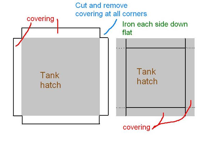

In general I do a pretty good job covering my models. But, I really struggle with corners. I'm talking about 90* corners. I just can't seem to get them to lay flat. What is your technique to do this? How do you fold the corners?

Sorry Bruce-Outside corners. Like you are going to cover a removable hatch and you want some of the covering on the back side.

I usually put on a small strip (@ 1/4 wide) on so it is at a 45 deg angle to both edges. Iron this down as you go around the corner and there isn't really enough to wrinkle. Then cover the major surface and iron it down while stretching over the edges. Eventuall you will need to cut a "dart" out at the corner and iron it down.
May not have stated this well but it works well.

Start at the corner and slice the covering out at a 45 degree angle. Now, fold one side over and iron it down. Fold the second side over and iron it down. Slice all four corners like this and keep working around until all four sides are ironed down on the backside. It's easy.

This is how I do hatch covers, rudder/fin and other sharp corners. Sorry for the graphics but I've never been very good at drawing.

yeap i just do like Shd920, but I cover the coner first with a little strip, this way no wood is expose.
Or do like 2slow say.
Concave such as flairing for the wing is a challenge especailly with super mono coat.
I end up just cutting little strips and try to make it look like rivet lines

Cutting the corners completely out also works good. Probably even better and cleaner than just 45'ing them. I use that method as well. All depends on the mood I'm in, I guess.
On compound and complex curves, where wrinkling seems inevitable, then that's where the difference between monocote and ultracote really shines through. I will personally not use monocote, unless it's one of the colors I have already in my possesion. Then I only use it to save the money. When I buy any covering, it's always ultracote.
