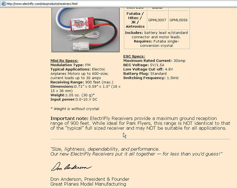

ORIGINAL: FatOrangeKat
Great planes has crystals for electrifly on Tower's site; they look just like Futaba crystals but are $5 less.
Note the "Requires Futaba Single Conversion Crystal" comment in the description. In your bigger planes I'm almost positive you'll have dual conversion receivers which use a different crystal.
