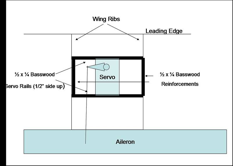

Could I see some graphics on exactly how to do the two-servo conversion if possible.

I am convinced to build the ailerons but could someone show me how to convert to two servos.

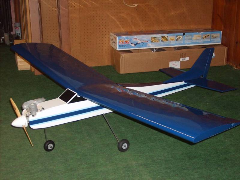

P.S: Beautiful plane Jester. How fast does that beauty fly with the setup you have? What's it powered with?

Thank you manks. One final question. How many ribs in from the wing root should the rails be? And would you suggest the B wing which is more sporty or the A wing for beginners. I think I am leaning towards the sportier version.
If it has any basis to the decision, I am also converting this PT40 to a taildragger.

I set up the plane so that the servos are close to the end of the ailerons, it is about 2 or 3 bays in from the fuse.
