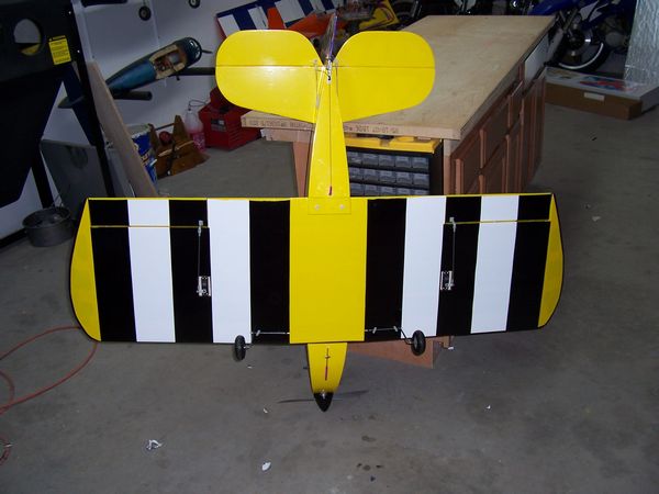

As a new learner I have trouble with seeing the plane.
I usually get a chance very late afternoon when the brease drops to nothin.
So What colour is easies to see?

Black and White.
When the plane is at a distance from you, the cones in your eyes, which are sensitive to color, are not a effective as the Rods, which are sensitive to black and white. Therefore, you should be concerned not with a specific color, but with the size and type of pattern on the plane. The pattern needs to be easily differentiated between top and bottom, front and back. Thats why you see lots of broad stripes, sunbursts, and checkerboard patterns. These shapes can be easily distiguished. For example, if you use a Sunburst on top, go with a solid color or a single wide stripe on the bottom.
Also consider the background you'll be flying against, particularly on landing. If you have trees behind the plane (green), use a light color on the leading edge of the wing so you'll be able to easily determine attitude.
Planes with a lot of white disappear quickly in a cloudless sky.

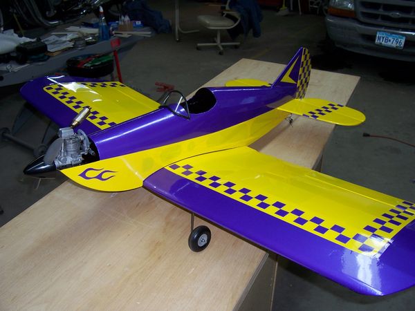

Good color schemes. They should stand out well.

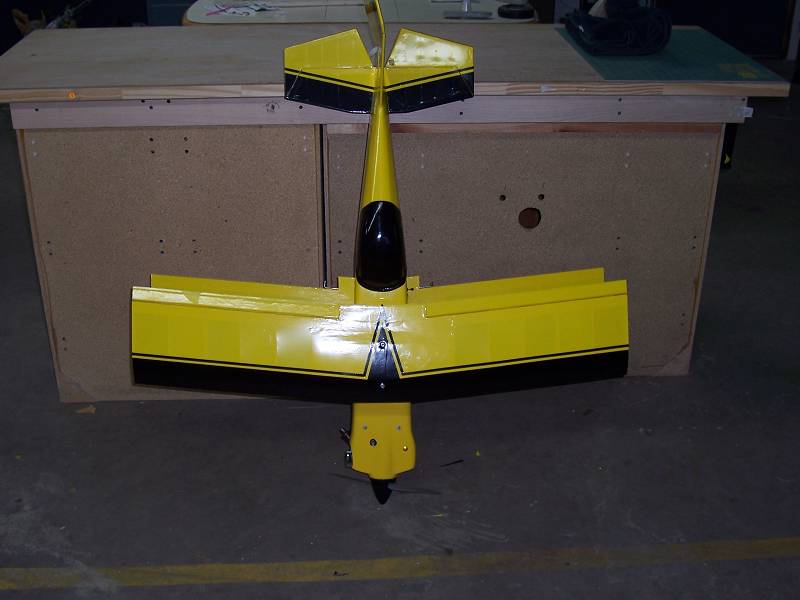

I've got a new plane with only two flights on it, both white knuckle ones. It is a Pheonix Fun Star. The plane is covered in yellow transparent covering. Before it goes in the air again, it gets a fesh covering of either white with Marron or black bars on the lower wings or Yellow with the same. Also the rudder and vertical will be contrasting colors.

The best thing to do is contrast vs colors.
Solid darker colors on the bottom of the plane with white stripes, and the top can be any design...but should have lots of contrast.
The best thing to do is lighter colors on the inside, and darker colors on the wingtips, and horizontal and vertical tips.
There are also patterns that help with recognition. Checkerboard, stripes, stars, etc. Just make sure to make them large enough to distinguish at a distance. If you make the checkerboard too small, when it gets far away it just fuzzes out.
