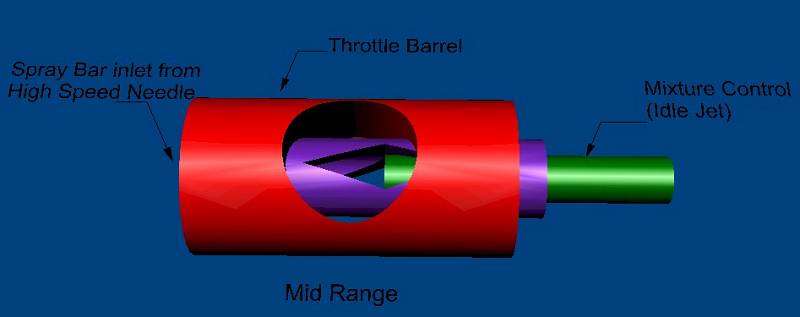

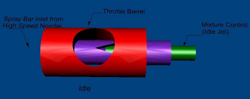

First, the carb has a throttle. Early cars used a vane for a throttle "plate", but our carbs mostly use a barrel with a large hole the size of the venturi of the carb. You can see this opening change as you move the carb. It is basically chocking off the air entering into the engine.
There is a bit more going on though under the hood. There is a spray bar, but this one is different from the Control line engines. It will have a long slot or diamond shaped slot that the fuel sprays from. There is also a Mixture Control valve also incorrectly referred to as the Idle Jet. This valve protrudes into the spray bar and partially blocks the slot. How much the slot is blocked depends on the throttle. At wide open, there is little blocking, but at idle it is mostly blocked. This is accomplished by a spiral grove on the OD of the barrel and as the barrel is turned, it is also moved from side to side, following the barrel spiral. This is what changes the amount of fuel being introduced into the engine in relation to the throttle. As the throttle closes, the barrel rotates to cut air and slides to cut fuel. This is a fixed change and can’t be adjusted. What can be adjusted is the starting point for this mix, IE we can fine tune how much fuel is allowed at idle, and the spiral increases in a set amount additional fuel as the throttle opens.
It is a basically simple setup. However, the initial setup is what is critical. If the mixture control is setup initially way off, it will effect the amount of fuel allowed in at wide open throttle. You adjust the High Speed needle and it really isn't running right. When you throttle down, the mix goes haywire and the engine stumbles or dies. You play with the mixture control and the mid gets better, then the high end gets worse. Soon, you have it putting over at 2000 rpm but you cant get it to run much faster. These are extremes but I have personally got a carb screwed up so bad that I had all of the examples in one day. The photos below show the relation of the throttle barrel, spray bar, and idle mix. The Idle mix moves as a part of the throttle barrel, and is fine adjusted by turning the screw. In the photos, I do not show the throttle barrel turning, only sliding to change the mix. In you engine, you will not be able to see the mix valve at work as the slot is not always visible

OK, I'll explain the Air Bleed carb. These are found on mostly lower end engines, and for some reason, on many 4 stroke engines. They are simpler to make, work pretty well, but they have their disadvantages as well. The biggest disadvantage is reduced fuel draw at idle. Most newbies will be finding them on engines like the OS LA series.
The Air Bleed carb has the same throttle barrel as the 2 needle or mixture control carburetor. It has a hole bored thru it to serve as the venturi. In this carb, the fuel inlet jet is commonly just a tube dead ending in the centre of the throttle barrel. The throttle barrel typically does not move side to side when opening and closing, it simply rotates. This simplifies machining. When running at full throttle, it's operating just like the C/L venturi described by Campgems. The engine is pulling air through the carburetor, and the air is accelerated to high speed by the smallish opening of the throttle. This creates a low pressure area in the venturi (or throttle barrel), and this draws fuel into the engine. The main mixture needle, or high speed needle, just provides an adjustable restriction so we can control the ratio of fuel being delivered relative to the airflow.
This setup works well with the throttle set anywhere above about 1/3 throttle, but below that the mixture begins to get hard to keep within the necessary range. Manufacturers of air bleed carbs design their carbs so that if there were no air bleed (or it was closed), near idle the mixture would be grossly rich. The air bleed allows us to admit a little extra air to bring that mixture back to ideal. When we open the air bleed screw, we are admitting a little more air into the carb below 1/3rd throttle, but it doesn't affect higher throttle settings at all.
As the throttle is closed from wide open, for the first 2/3rds of its rotation, it's open only to the big air intake on top. As it keeps closing, it begins to uncover the air bleed hole inside the carb. As it keeps closing, more and more of the air the engine is breathing is coming from that air bleed hole. We simply adjust that hole's opening with the air bleed screw until the engine will continue idling for a long time without starving for fuel (too much bleed air, lean) or loading up (too little bleed air, rich).
