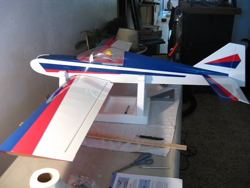

Ok I got the wing together and like I said it went great. Mounting the servo the instructions were not that detailed but I figured it out from the pic. I had to use the dremil to grind the center ribs a little so the servo fit good. The wire comming out of the servo was hitting the center ribs. After it all fit well I epoxyed the assembly into place. I used 30 min epoxy thinned with denatured alcohol and painted the exposed wood before I mounted the servo. I went to put the wing on a noticed the torqe rods hit the wood were the mounting screws went into...so I used the dremil to clear it. I am taking my time with it but I will be done in less than 2 weeks for sure. I am letting everything cure over night before moving on to the next step.

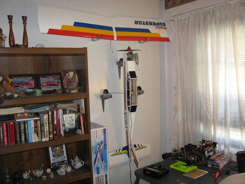

I threw in a pic of my superstar. The poor thing is so beat up...but still flys and I am on my way to fly her some more!!

How have you made your craddle for your plane... it's kinda usefull in the building time as your plane is more stable and can be put in every side...

The craddle I use is a store bought deal it made of foam and costs about $11.

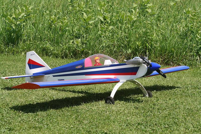

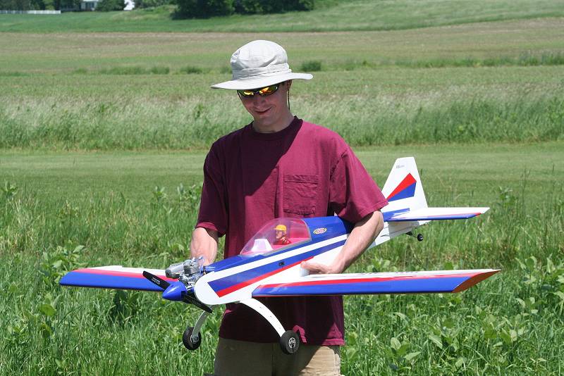

Here are the pics of my Dolphin with the Dubro Super Strength landing gear. I painted the gear white, and drilled out successively larger holes down the sides to reduce the weight.
2 nylon bolts in the gear have been holding up VERY well. Also have some extra holes drilled out of the mounting plate, which at first were by accident, but now act as weight reducing holes. I've had some hard landings after some weird radio interference, and it doesn't phase the gear.
I know we were talking about changing the wheels. I would keep with foam wheels as they are lighter. 2.5" from my Nexstar have been working very well for me on the short grass runway, but I could see using 2.75 or even 3" just for looks, mostly because of the beefed up gear. Also my tail wheel has been fine, but again I could see going to the next size.
I think I have extra prop clearance with the new gear. Doesn't look bad though. I've been using a master airscrew 11x5. It jumps off the line, and I definitely have to kill the throttle in a climb before it's uncomfortably too high. I'm not sure about turning a 12" prop with the 46AX - I've been advised not to bother due to very noticeable loss of RPM by many people.
This thing is a blast! I've already banged it up a little, so it now has a black canopy and an extra sticker or two, but still looks and flies great. I did my first two knife edges today. Have to keep the speed up, but it does them VERY well. I balanced my CG based on inverted flight characteristics, to where I need about 1/4 to 1/3 down elevator to keep it flying level while inverted. Very easy to fly the pattern inverted with this plane. Rolls are very smooth, not too slow (definitely not blazing fast) and loops are plenty tight now that I've got the rudder trimmed properly.
The only thing I have to work on is speed control - I'm apparently landing pretty darn hot according to the club instructors. They flew it and said there's not much transition between idle and faster speed. I think it might just need getting used to the lower flying weight than the Nexstar. One or Two clicks above idle might be all I need to land this plane, but I've been trying to land closer to 1/4 throttle, just because I thought that's what landing under power meant, and what you are supposed to do. Because of this, there is a tendency for the plane to balloon when it gets near the runway, due to the 'ground effect' I'm told, and because I'm flying in too fast. Practice, practice, practice.
This plane is fun, I love it sooooooo much
Also, you can see behind my plane the tall grass I accidentally landed in last week. Doesn't look to harmful but it was enough to split the plane into 2 pieces!

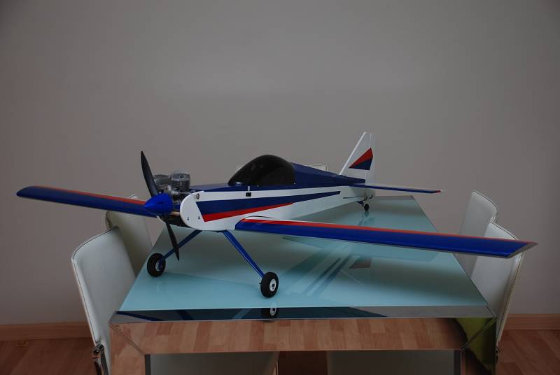

Just adding some photos of the mods I made to my dolphin.
First off I got rid of the "gay lumberjack" pilot and sparyed the inside of the canopy black.
Then I added a fibreglass undercarriage, which I sparyed with metalic blue which matches the blue oracover perfectly! I had this can by luck as my car is that colour!
having great fun throwing this toy around the sky!!!!
If your thinking of getting one, just do it, slam in an os 55ax and do some stress free flights. Its so cheap it cant be worried about if you dent it!
