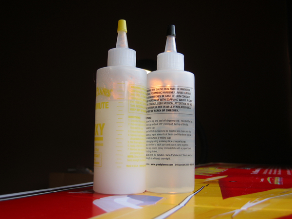

These are 60min Great Planes Epoxy. The yellow component has turned somewhat thick and white-ish. -Is it normal? I just mixed some to see if it cures right.

Plugin,
No your epoxy is not bad, but it needs some help!
What has happened is the molecules of the "A" side or the resin have lined up for some reason. This happens more often in colder climates or storage areas. To fix the problem put that side in the microwave for about 15 seconds, this will excite the molecules and clear up the problem. After you have "Nuked" material shake it up to speed the clearing of the resin. Usually one shot will do it.
Be careful not to over heat as it will melt the container.
Wait until the A side cools to room temperature before using or potlife will be greatly reduced giving you a much faster cure if used warm.

Wow I just put it in the microwave and I'm waiting for it to cool down but it did clear up a lot! Thanks Steve.

Osirisf16, it's an excellent result. The epoxy is now clear like the day it was bought. It's amazing how well this works. I gave it 20 seconds in the microwave, it came out very diluted and when it cooled down it was like new.
