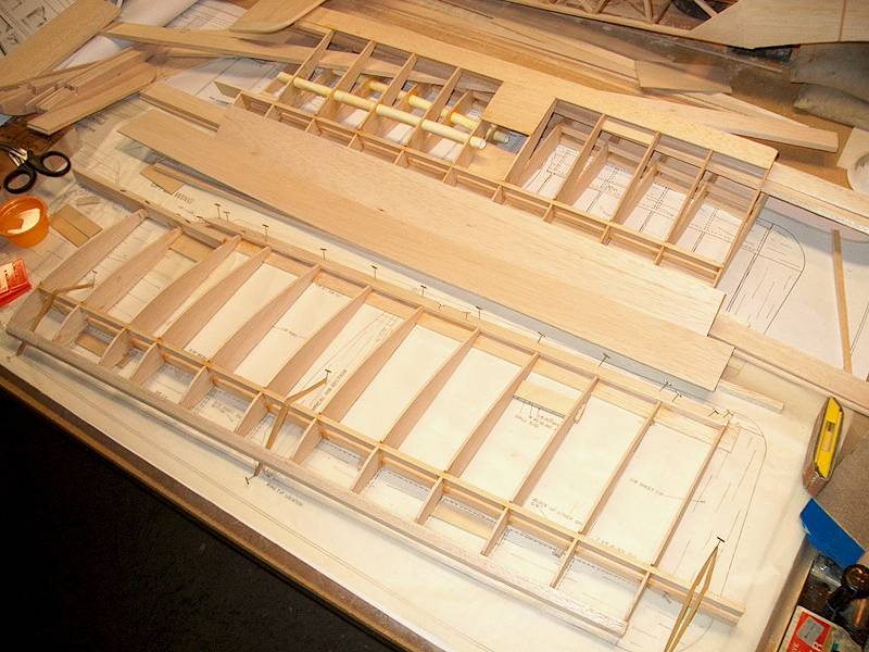

Minimal space would be the length of the longest solid or assembled flatcomponent: as in spar or fuselage length. If the wing is built in two pieces and then joined you can get away with half-a-wingspan of table space UNLESS the plans call for the parts to be joined with one tip elevated a certain height to form the proper dihedral (in which case the floor is handy). I have a 48" x 18" end-grain balsa building board that is a wonderful surface to build on.
I have a 4' x 8' table, 3' x 5' bench, 3' x 3' saw table surface, 2' x 3' radial arm table surface, 2' x 4' charging bench/electrical area and I STILL run out of room! Crap expands to fill all available surfaces so enough is never enough.
Bigger problem is building over carpet. A sheet or two of plywood improves the problem.

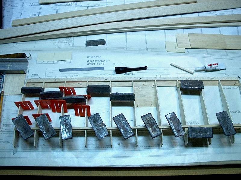

I use solid core doors (have 3 at present), though I had a hollow core in the past. If you got room to work on both sides you can work on one assembly while another is drying. Same logic with 3 doors.
I don't use anything to pin into. I've never seen a really flat ceiling tile so I tape the plans in place, cover with wax paper taped down, and then tape parts to the table. Lots of weights and clamps help. The magnetic tables look really good, but something else usually collects my coin. A balsa bulding board sounds good. Who sells them?
I got mine from a firm that used to advertise in the back of RC Modeler but I'm afraid they, and the magazine, are kaput.
http://www3.towerhobbies.com/cgi-bin...&I=LXPF36&P=ML
And, with angled "T" pins and rubber band, one pound lead weights and a stack of House of Balsa 90ΒΊ jigs it will do everything a magnetic board can do. ;-)
http://www3.towerhobbies.com/cgi-bin...&I=LXM406&P=ML
