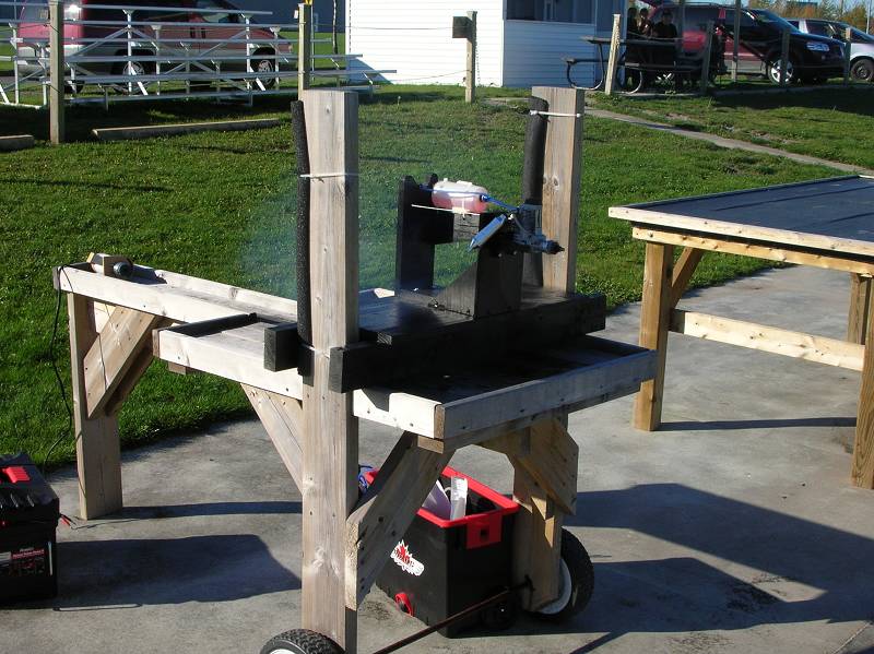

My dad and i built 2 last year and they are used most of the time, I also have an engine test stand that is bult to fit the stands the 2 other stands we built have room for a tx and tools Il try and get some pics of those next time im at the field (the one in the pic is the original design)
Steven

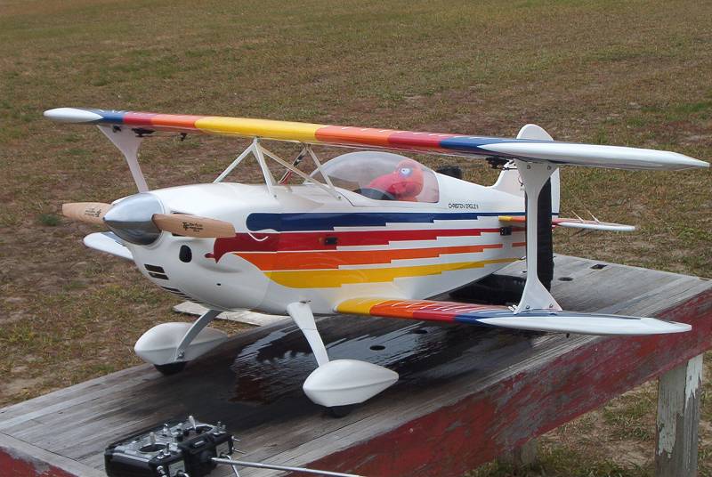

Campgems,
The bench is made from 2X6 cedar, the inside pieces are ripped in half and layed on edge, giving a thickness of 2-5/8th, this is all glued and screwed together. The outside perimeter is just 2X6's. The table is 28" X 74" with a height of 26-3/8" The nice thing about doing it this way is the size is up to you, make it as big as you want. It's a bit unmobile though and quite heavy.
The holes are 1-3/8th" and are spaced 6" apart, starting 2 inches from the back for a total of seven holes.
The restraint is all galvanized pipe, a 1"x1/2"x1/2' Tee, with 2 short pieces of 1/2", a 90, and then a 12" piece of 1/2" for the uprights, and a 6" piece of 1" for the bottom stub, this gives you a 1/8" of play in the holes for easy removal. Alot of guys use PVC holders, BAD IDEA!!
Your edge piece is an excellent idea, just a piece of 1X standing up about an inch would be perfect. This table could also be set-up for wing restraints using pieces of 1/2" pipe with a coupler on the lower half and the holes drilled at 7/8" I have a couple of these for the club, which uses PVC.[:@] The reason is, I've seen one break.[]
