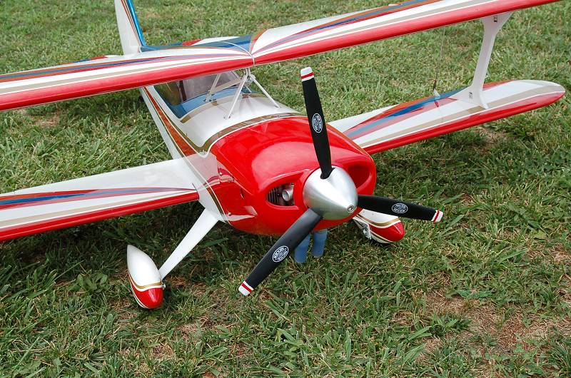

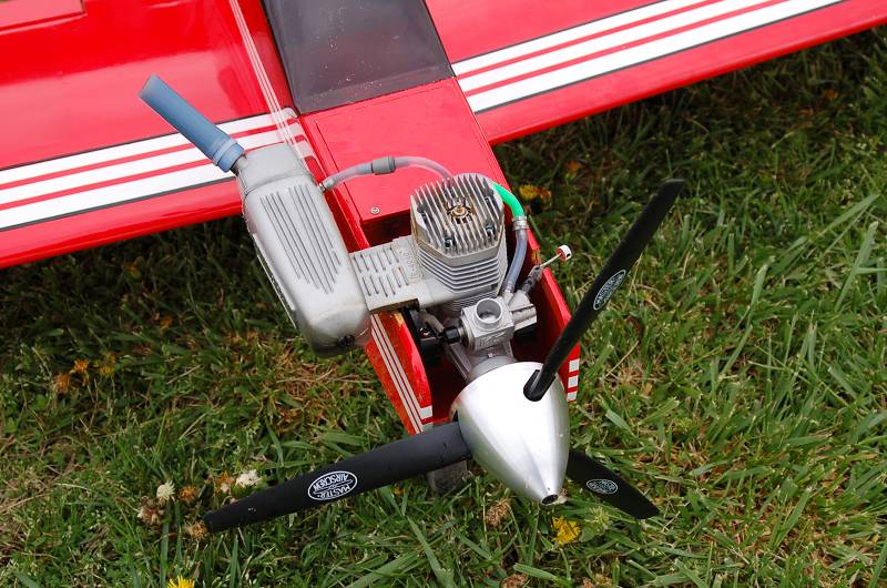

There is a large silicon tubing sold at LHSs. It's supposed to be "tuned pipe connector". There are a couple of different sizes. One fits the exhaust pipe of my OS mufflers and also the pipes on Slimline Pitts mufflers.
It fits tightly enough that if there is enough pipe covered, it'll stay on without help. But I needed to use a clamp on the Tiger60 muffler's pipe.
That's just a plastic tie-wrap on the Tiger pipe. The Skybolt didn't need anything to stay on, and can be pulled off and replaced and stay just fine.
If there is any loss of power, it's not obvious.
