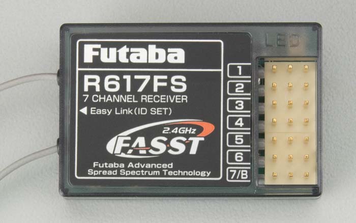

Hey guys! I have what you will probably think is a really stupid question. How come in my old receivers, there was a spot on the receiver for a battery connection, but the new 2.4's don't. I just got back into the hobby after 15 years and prurchased a new Futaba 7 channel. But I only have place for seven connections on the receiver. Where does the battery connection go?
Told you it was stupid. what can I say?
Richard

Old 06-15-2008 | 05:22 PM
oldvet70's Avatar
My Feedback: (10)
Joined: Sep 2004
Posts: 694
From: Grants Pass, OR
Default RE: Dumb Receiver question
The battery can be plugged into any open channel, it doesn't matter. If your using all 7 channels then use a Y connector and plug the battery in that way. If you look close channel 7 also has a B next to it, 7/B.

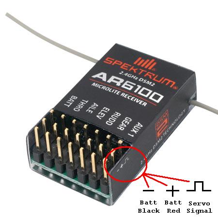

CGRetired's Avatar
Joined: Sep 2004
Posts: 8,999
From: Galloway, NJ
Some receivers have a little diagram as to what goes where. In the case of the picture below, this is a Spektrum receiver with a little diagram on th side showing what goes where for servos. The Battery Red and Battery Black.. may be Battery Red and Battery Brown.. but it is pretty clearly spelled out.
Some other receivers have a separate battery connection. The Spektrum AR7000 does as does some of the Airtronics receivers. But, the battery can go in any of the vacant slots as long as the polarity is observed. Battery + and Battery - have to match up with whatever the receiver slot requires. For the battery, there will be no 'servo' connection. Just two wires, red and black, or red and brown, and some may be white and black. Just make sure that they match. The manual should clearly spell that out.
CGr.

oldvet70's Avatar
My Feedback: (10)
Joined: Sep 2004
Posts: 694
This is the receiver Richard Scale Rocks was asking about. It's not much help for a beginner to give them information about a completely different system when their question is specific. We should be trying to help not confuse the beginner.
