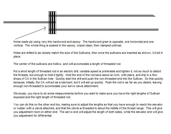

Wow.. there has to be a better solution than mixing in opposite aileron to counteract the differential.
Perhaps matching servos, but this could be a pain in the butt. Or remove the two servos and adding one with two pushrods.
My Venus II has one servo and a dual pushrod setup to control the elevator movement. I used Sullivan Carbon rods and a method to join them at the servo end. The servo was in the regular servo tray. The pushrod guides were secured at hard points along the formers to prevent any flexing. At least they both move the same amount. But, I do have a Super Star 120 that has a pair of elevator servos and this was one of my concerns. I am anxious to see the replies to this.

I put together a quick drawing of how I did it on my Venus II. I used an Airtronics 94731Z heavy duty coreless servo (high torque). Of course, any similar servo will work, I just happen to prefer this particular servo.
Anyway, I used the Sullivan Composite rod, http://www3.towerhobbies.com/cgi-bin...?&I=LXFV44&P=7 and a home made piece of plywood. See the below drawing. This setup, if secured properly (sand the sleeve at the hard points at formers, cut a slot the size of the sleeve or drill a hole in the former to accomodate the sleeve, then epoxy it in place at each former) is very strong and works well even up to 2 meter pattern.. so it will work on just about anything. It takes some time to do right, but it works and allows adjustment for both length and differential.
CGr
