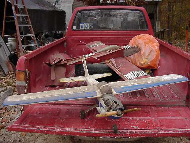

Hi all, I am new to this R/C airplane world but flew line control when I was 11. I'm 52 now so out of practice. A friend bought a property here in the Arkansas River valley and in it were these 2 airplanes. One looks like a cessna and the other a crop duster. The Cessna has a 56inch wingspan and is approx 45.5inches long. It has an OS Max 60H motor that is locked up and electronics are pre1992. It had an AMA sticker on it so I wrote them but have received no reply and am wondering if they are stuck up or something. Anyway, I'd like to know who made the kit and is it worth fixing. Please recommend a replacement engine and electronics. It also has a hole in the wing and a cracked tailfin passenger side. If anyone out there is from the river valley and would be willing to give me some advice, I'll bring it and meet up with you. I am uploading pic and you can email directly at: [email protected] Thanks, Andy
PS It has 2 large plastic screws that hold wing on.

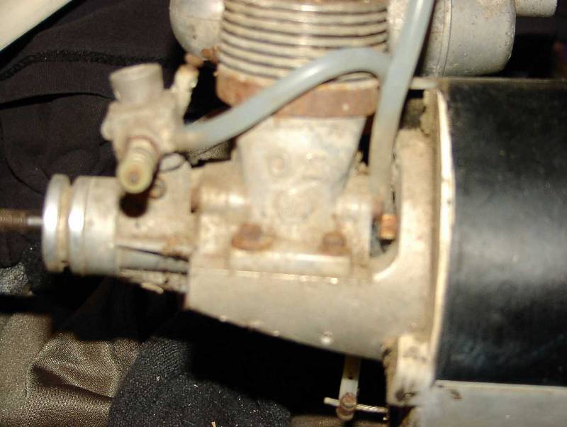

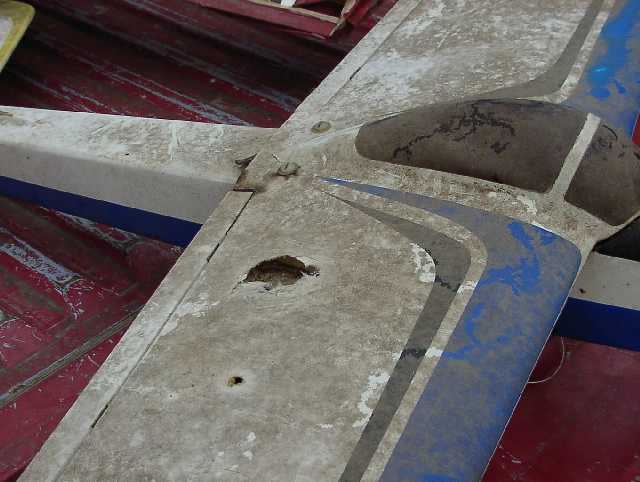

Neither airplane is a Cessna or any kind of scale airplane They are both likely from the early eightys or late seventies two of hundreds of possible design sport airplanes.
Electronics are almost certainly a wash and not usable likely not even on current frequencys or legal to operate.
the engines is also in such a corroded states reviving it for any real functional use is going to be a major challange.
The airplanes can of course be repaired and flown however that takes some modeling skills and the airplanes are not really appropriate types for learning to fly. In short if you want to get involved you best start with current appropriate equipment and you will spend far less money as well as improve your chances for success.

(Sorry couldnt resist!)Seriously, most of the answers have been given, but I would give this: Clean up the planes and motors before you write anything off. Chances are the engines are more trouble than worth, but it IS an OS so i would at least try myself.
The air frames look mostly intact, so it a matter of going thru the control surfaces, re-hinging, and recovering as necessary. (Blue and white one anyhow) Assuming you posses some basic modeling and or woodworking skills its not very hard to repair.
That said, those are DEFINATELY not trainers, so while I would most assuredly try to fix em, I have to go with the others in saying get a good trainer and learn on it first. I will also parrot the find a club line, its really the best way to go unless you are:

Yeah, I agree with that. I had a used, old, OS 61 SF that I bought from an estate sale, got it rather inexpensively. I took it home, put about a quart of fuel (regular glow fuel) in a small bucket, and just dropped the engine in there and let it soak for about a week. After I was done, I drained it thoroughly, and put it on a plane, a Tiger 60, by the way, and it started right up and ran just fine. It eventually needed bearings, but with all things considered, that was a cheap quality engine.
Chris has that engine (Overbored) on one of his planes. I gave it to him for his clipped wing Tiger 60/tail dragger. He replaced the bearings, and it flys today. A great engine.
So, never say die. Let them soak in something (I recommend just plain old 15% nitro is what I used, but any fuel with oil will work) for a while and then clean them out/off and see if they turn and if they have compression. If they do, then what the hell... put a new glow plug on, and start it up. You never know.

Thanks guys for all your replys, I checked the OS website and as best as I can tell it's a 1967 model engine. I have a nice Exacto knife set that I've always wanted to use so no matter what I intend to repair the blue and white one. I have determined that the red one is beyond repair as it was exposed to a water leak. All your recommendations were good but as I am stubborn, I need to know how to reskin it and what type of glue I should use. If you know a link to these instructions, I appreciate it. I'm going to study this website as I'm betting my answers are here. I had no intention of ever trying to fly this plane. If I go to all the trouble to fix it you can bet that a pro will giver her first trials. Can you guys recommend a radio that I could use with this plane and a trainer? I figure that would save me a ton of dough. Oh yeah, the prop is a 11 x 7.5 whatever that means. Is their a R/C flight simulator for a PC? Snobelt, you can send a pic to my email address! Thanks again, Andy

Well the plane on the tail gate is a SIGs Kavalier from back in the 70s
Got to thinking
[:@] the red one was made by Royal sort of like the firts ARFs with stick on covering and checker board markings, both fly very well the Kavalier is a second plane.

andermac,
The Sig Kavalier kit is still in production, and plans are available from Sig. The horizontal is a built-up assembly – stick construction with sheeting on both sides and shouldn’t be too hard to fix. This is a very stout, rugged airplane.
The Kavalier is not a primary trainer and was considered a basic, aileron, or secondary trainer (this was from the era where you learned to fly on rudder/elevator/throttle, no ailerons). Don’t try to learn on it, get a proper trainer instead. But for a secondary trainer it’s a great plane. Power wise an OS .46 AX, Thunder Tiger .40 or .46 Pro, or Super Tiger GS-40 or GS-45 will all work great – it doesn’t need any more power than those. Look through [link=http://www.rcuniverse.com/forum/m_4537845/tm.htm]RCKen's list of trainer aircraft[/link] for a good primary trainer. If you get something that is considered RTF, or ready to fly, you could transfer the radio and engine over to the Kavalier when you’re ready to fly it.

Hogflyer your the man! After rereading your post, I am no longer sure it's a Kavalier. It has ailerons I believe. They are on the trailing edge of the wing and move up and down depending on which way you turn the rudder. I've got the aircraft wired up in the ceiling as I am adding an addition and space is at a premium. It's been cleaned since my original pics so I'll take some more and resubmit in next day or so. Front wheel steers with rudder turn as well. It sounds like you know your engines but it has a OSMax 60H. Your saying that an .046 will replace it. I'm really over my head when it comes to the miniengines. I've been a mechanic for 46 years and I can fix most anything is I got a manual but I don't have one or a schematic and really don't even know how to disasemble it. 41 years ago, I got a line controlled blue and yellow trainer with rubber bands to hold wings. I crashed it so many times trying to do stunts that finally I glued tail straight and rudder slightly up and just let it fly out of sight. I bought a twin engine Stukka after that and I couldn't keep engines running or tuned right and when one quit and it heeled over and dove into the ground my flying days were over. Take care and thanks for the advice. Andy

It wouldn't be an .046, but a .46 like [link=http://www3.towerhobbies.com/cgi-bin/wti0001p?&I=LXJA86&P=ML]THIS[/link] or [link=http://www3.towerhobbies.com/cgi-bin/wti0001p?&I=LXFV71&P=ML]THIS[/link]

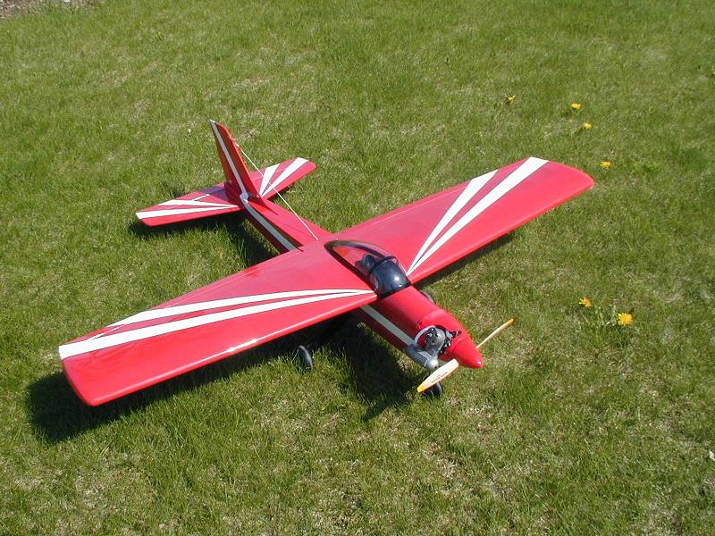

Snobelt thats a beautiful plane. It looks like it has ailerons. Your pics didn't show up till a little while ago or I would have said something earlier. Thanks for sharing. Mine looks a lot like that except no fancy nose cap. Andy
