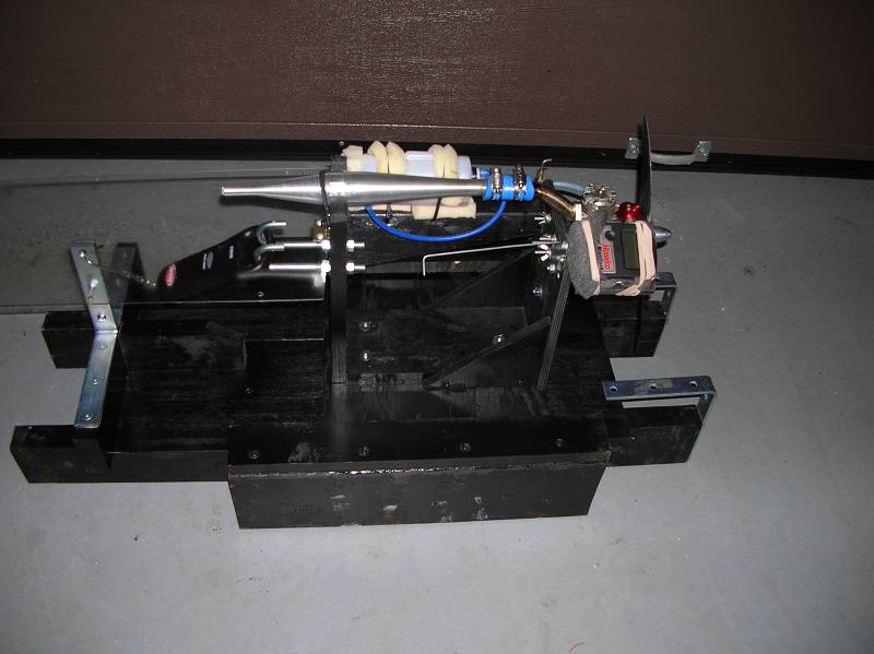

Has anybody built a motor test stand appuratus that can actually measure thrust / performance ????
If a testor mechanism was built, it'd allow for a more scientific comparison of prop/motor comparison.

These devices are very simple.
Many of the popular RC magazines show them in use.
One easy way to do this is a simple fish scale anchored at one end, and the other tied to a plane.
A bit more elaborate is a normal weight scale, with an "arm" ( like an upside down "T" ) on the scale, and a hinge at the other end of the "T".
The motor is attached via a line, etc. to the long part of the "T".
As the prop "pulls" it places a downward force on the scale, indicating thrust.

Somthing like this?
Steven

If you go to www.evflyers.com this club site has one they built and take to the field with them to test thrust and props on/with different planes and engines. They even have A chart showing the readings of different engines they have tested. It was worth the look and I even signed up with them. Very simple and clean unit.

Thrust calculators assume that all propellors are created equal. The truth is some are more equal than others.
I'm interested in knowing how much my prop/engine combo can bench press without feeding the force through some Rube Goldberg setup. I set a stand up where the engine has to lift itself plus a known quantity of weight against gravity. I know what the ball park amount should be based on what a thrust calc says, then fine tune the test load with .5 oz weights until equalibrium is reached.

I've used mine to help develope props that nobody makes. For example, 7x2 & 8x2 sizes for small 3D glow projects. There are other examples where no "off the shelf" prop for your application is readily available. I'll bet the Wright Bros. did thrust testing before committing to a final prop design.
