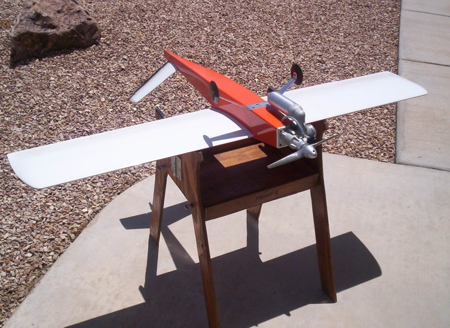

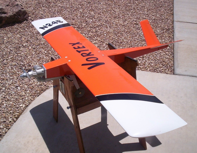

You know what, if you can hang onto for a while as your skills mature a little they are great fun and the make pretty good sport airplanes by using a good .25 instead of a .40. I ran what we called slow quickee races here for several years to get people involved and the races were great fun even with the .25's and less intimidating.
John

I agree with HighPlains that the CG should be no further back than 21/2 inchs. But still suggest that unless you are being mentored by someone with at least some experiance with that type airplane and you are right off a trainer that it won,t live to long. They are great airplanes and fun but they are not Sticks and will never fly like sticks. Can you do it right after the trainer? You bet if you get someone with experiance to test the airplane first and then mentor you through the transition.
Is it V tail, most these days are?
Do you have a radio capable of a V tail mix?
It may be a GP viper (pretty good airplane) but if it has the GP pizza cutter wheels they are of poor quality and break easily. At any rate if they are, best you replace them with conventional wheels for now.
Most likely the airplane has a tail skid and trying to install a steerable tailwheel particularly on a V tail is problamatical and unneeded but it means the airplane will not be taxied like a typical Stick and the best method for takeoff remains a thottled up release by a helper. Agine unlike a typical Stick Quickees do not have but very little propellor ground clearance and it you try taxing a lot then you are going to need plenty of props. Agine landings will be easier with engine shut down.
