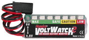

or put one of these on your plane so you know at a glance: $12
http://www3.towerhobbies.com/cgi-bin...&I=LXHDJ2&P=ML

No, it's not bulky at all. It's about 2 inches long, 3/4 inches wide, and about 1/8 inch thick.
I usually cut a slot the size of the LED strip in the side of my fuselage somewhere in the radio compartment. Then I paint the balsa with flat black paint, then put the Voltwatch inside the fuselage with the LED's facing outwards (of course.. ) with the green forward, red toward the back. So, you read it left to right. I then take a small strip of clear monocoat and put that over the hole, and voila.. you got your voltwatch mounted, clean and simple. Oh, I tape it to the inside of the fuselage, hold it there, with a strip of 1" Blenderm adhesive tape, available at any good medical supply store. The Blenderm is strong, flexible, and easy to use.
Here are the spec figures from Tower:
Length: 1.65" (42mm)
Width: .63" (16mm)
Height: .16" (4mm)
Weight: .15oz (4.3 grams)
Current Draw: approx 4-34mA
If you look closely enough, on the left side there is a 4.8 volt - 6 volt slide switch to select your battery type.

AstroDad.. on one plane, one that had a removable canope, I actually mounted it in the "dashboard" so the "pilot" could see it. Looked pretty cool. I also cut through the thin ply to make it fit in.
It just takes a little time and careful cutting to put it wherever you may wish to put it. The only 'requirement' is that it is clearly visible when you need it to be visible. Obviously, you can't see this thing from the air. It's not for that. It is a 'before and after' device in which you get the 'warm and fuzzy' that your battery pack(s) are functioning and have a decent and usable capacity to continue flying.

for my high-wing trainer I have the best access and space on the fuselage below the wing, but it is going to be a pain to see when doing pre-flight because the wing will be blocking my view as I stand above the plane.
I hope I can find room to install it on the top of the fuselage behind the wing, but space will be tight. I might even do a fully external install on top of the fuselage behind the wing. If external, I might build a little aerodynamic structure around it to reduce drag.
here is a photo of my airplane. http://www.hangar-9.com/ProdInfo/Lar...es/HAN2550.jpg
so I am thinking if I have to go external, then on top of the fuselage behind the wing might be the best external location?
