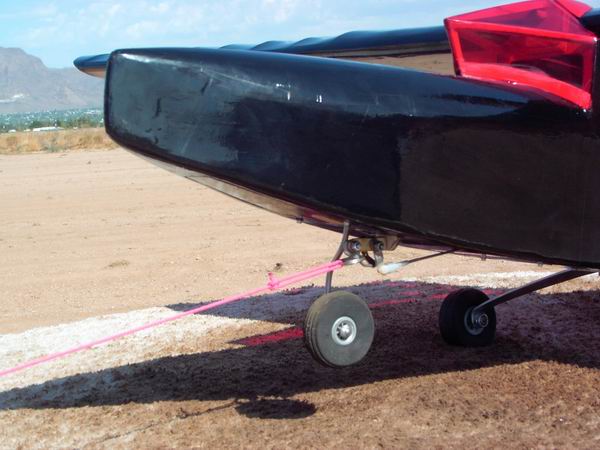

Here is the home made pelican hook servo actuated along side the nose wheel. The hook is centered and the nosewheel offset to the side.

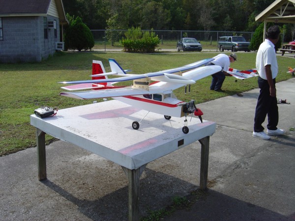

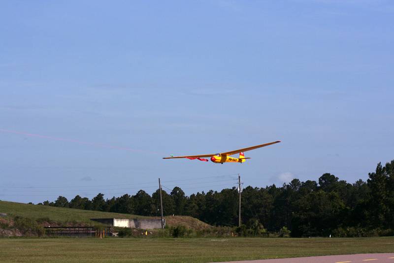

You have to install a releaseable tow hook in the nose of the glider. Also to be ideal, the tug should be able to cut the glider loose as well.
Size is good here's the one we've been using.
ID:	990474   Click image for larger version

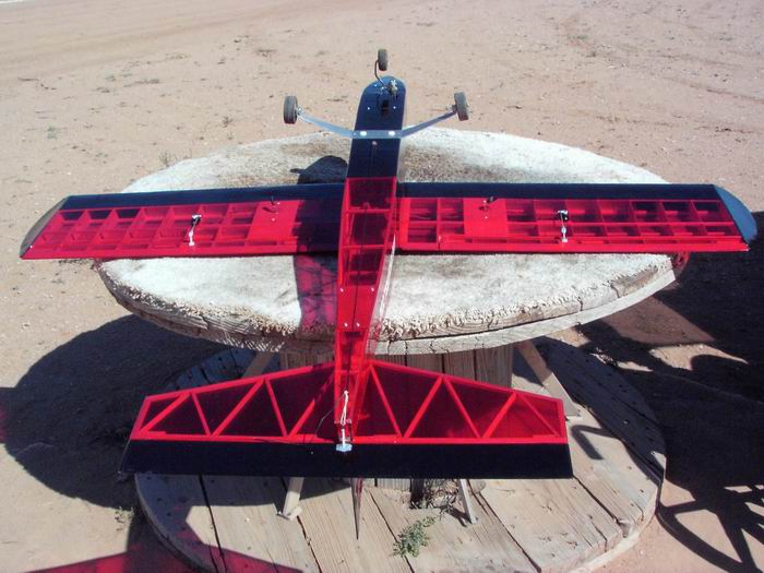

Actually, there's a better way to do it.
What I did was to build a cradle that mounts to the top of the wing on the tow plane.
The glider sits in the cradle and is held in place by rubber bands.
When you're ready, the rubber bands are released and away goes the glider.
Two big advantages to this system are:
1) you don't have to worry about what position the glider is in (Too High, Too Low, etc)
2) you can use ANY glider - IT doesn't need any type of release mechanism

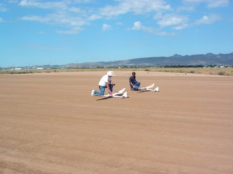

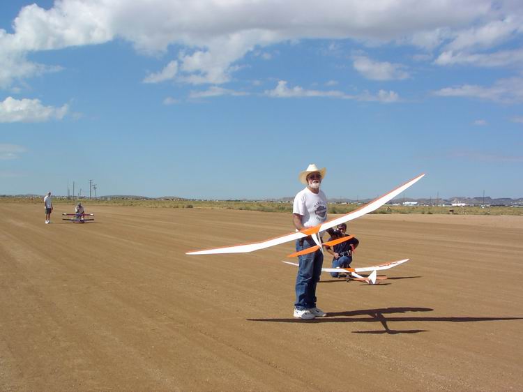

Piggyback launchs are cool and a lot of fun as well as easier but I would not neccessarily call it a better way. Thats because it does not offer challange and skills that must be acquired with aerotow on both ends of the towline.
Aerotow for those five or six that I have mentored into the technique becomes the whole point of the flight and some will circle down quickly to get in another tow.
Here are some of the wheeled launch dollys I built for the guys using conventional gliders:
ID:	991082   Click image for larger version
ID:	991083   Click image for larger version

Pretty neat! Does that pivot up to allow the rubber bands to snap off? Do you actually tie the bands off so that you don't lose them?

Cradle launch is safe but boring after you've done towing
We have been there done that too.
On ours the rubber bands are secured on the back so they just flop around after the glider lets loose.
ID:	991195   Click image for larger version
