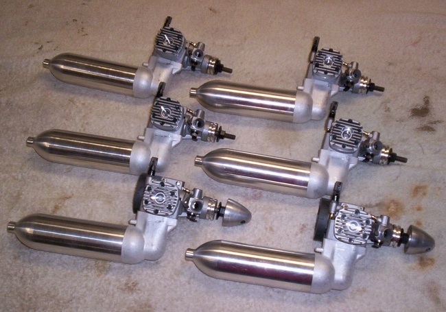

What bothers me about this project is its apparently your first glow airplane and the fact you have choosen to post in the beginners forum. I cannot think of a more inappropriate first glow airplane and even worse doing it as a glow conversion.
To be honest a far more practical engine for this airplane would be a good .15 and more likely to contribute to the airplanes longevity. While it may not be a blood curdling hover monster it would be a much better step along the way to building your skills.
Having said that if you insist there is only one combination I would use with that airplane, An OS .25FX not a .32 or .36 and if spell binding power was desired then equip it with an Ultra thrust quarter wave pipe from Performance Specialties in Nevada like these. It is a true quarter wave tuned pipe, not an empty can muffler like the tower muffler.
John

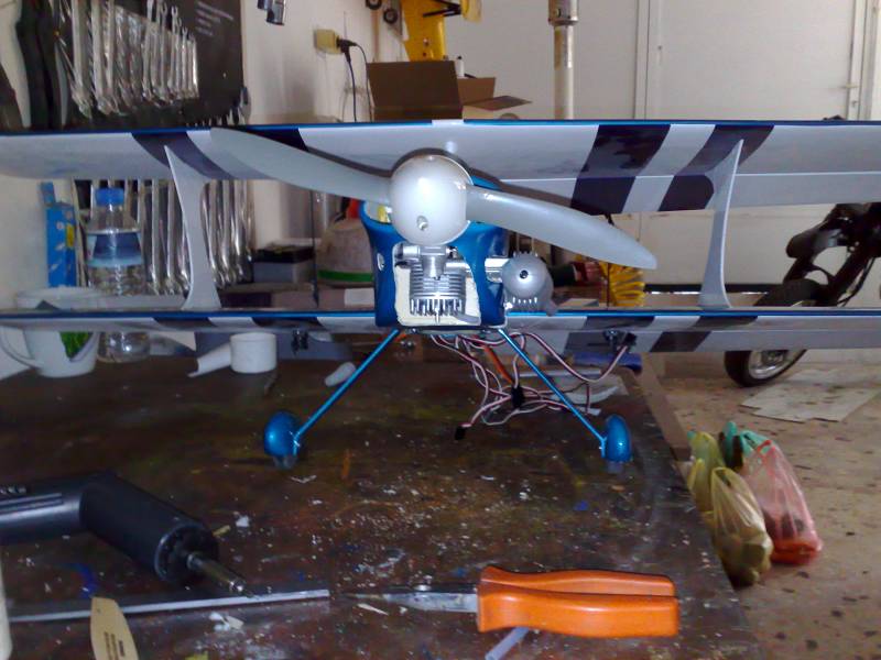

after 2 months of hard construction i finally finished the conversion to the reactor bipe thanks to the help of a friend and yours.
here are some pictures and a video of its first flight.
The video is taken by mobile phone so dont expect too much.
Thanks again everybody[sm=thumbup.gif][sm=thumbup.gif][sm=thumbup.gif]
http://www.youtube.com/watch?v=8n1hQ2I-Yxg

Old 09-30-2008 | 01:30 PM
bigedmustafa's Avatar
Joined: Jun 2005
Posts: 4,110
From: Omaha, NE
Default RE: great planes reactor bipe conversion
That's awesome, rmcctr! Congratulations, it looks like a nice flying plane. It warms my heart to see electric planes converted to glow.
How is the .25 FX going to work out? Do you have the power you want for 3D aerobatics?

Joined: Jul 2008
Posts: 7
From: keratsini, GREECE
In the video the motor is running in half throttle because i didn't want to push it to much on it's first flight.
So the motor is running very well.The plane was climbing easily with half throttle.
I will post another video with the real test when i find the time to do it.
