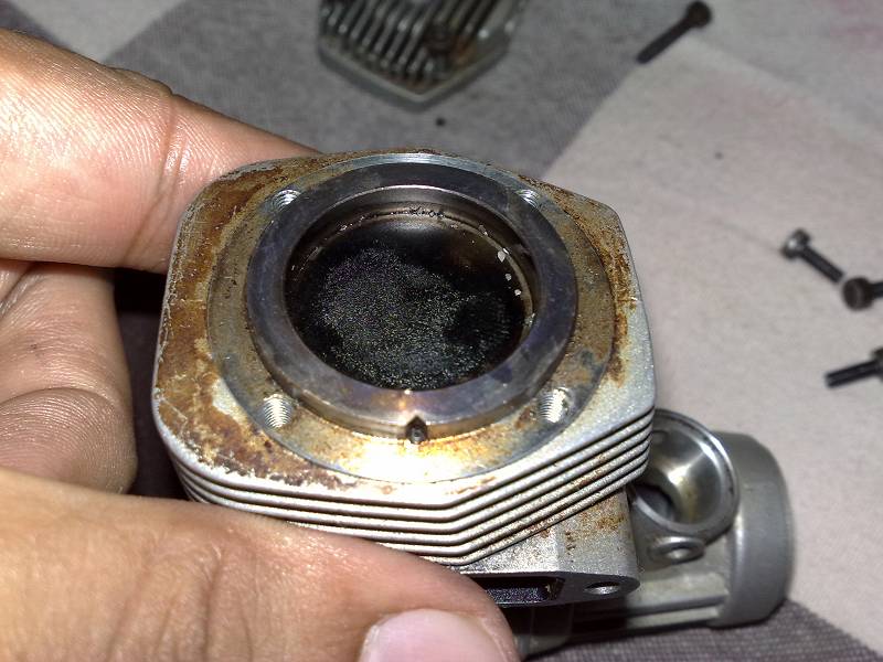

Dear All,
recently broke the connrod on my 55 ax. Shards of the rod probably seized the piston. Repairing will cost more than 60% engine price so bought new one. Now that the engine is gone, I want to know of any mistakes we made. I am posting the pictures (two months out of use, so may be a bit "brown"). Can you guys make a diagnosis?
AMEYAM
ID:	1060600   Click image for larger version

Mike, he really needs to show that to Bill but I really wanted to know what he is using for fuel and how much run time is on that engine. Just an FYI thing, I have glow engines that are years and years old with I don't know how much fuel run through them that don't look anything at all like that. Just an inquiring mind wanting to know??

I'm curious too. Not enough oil? Running too lean or too fast?

Yeah I thought I posted here but I guess I didn't hit 'ok' but I've got a long season and 12+ gallons through my 46AX and it is nowhere near that black on the piston. My guess is the engine was too hot, too lean, and improperly lubricated due to fuel starvation and kicked the bucket.

"Rode hard and put away wet."

what kind of fuel were you using?
