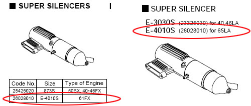

I am trying to find a pitts muffler for my O.S. La 65 and I am having some trouble. There is a pitt muffler made by Bisson ( [link]http://www3.towerhobbies.com/cgi-bin/wti0001p?&I=LX8681&P=ML[/link] ) for the O.S. 61 SF/FX and I think it will fit the LA 65 but I'm not sure. Does anyone know if it will fit? If It will not fit is there a pitts muffler made for the LA 65?

I don't think so. I believe the FX has a wider bolt pattern than the LA series. I could be wrong though. Can anybody verify this?

My first instinct was to say the same thing. I must admit though, this was a rough search to find out. Went to Slimline and Bisson's sites and couldn't find anything. As a last grasp I checked the manuals for the dimensions of the exhaust ports, but neither manual listed the size of the port. And then as I was ready to give up I came across this in each manual. The part numbers for the stock mufflers. They are identical. SO..... Yes, the same pitts muffler will fit!!!!

Great Thanks for the help!!! I Will have it ordered here in a few min!!!!!

Great! I looked on the aforementioned websites and couldn't find anything. I never thought of looking up the part numbers in the back of the manual.
