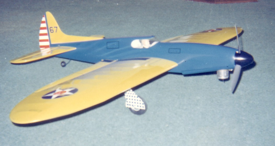

P.S. Pictures of our earlier modeling career efforts...

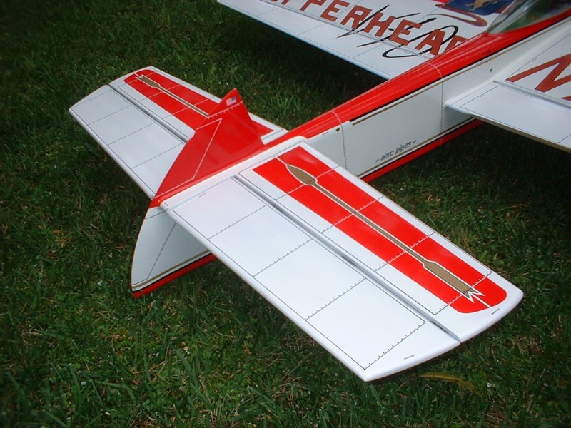

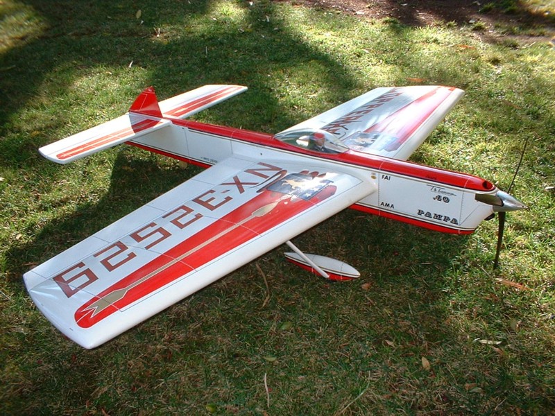

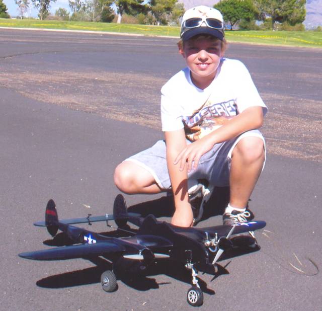

Our club wants to put in some C/L circles so we can fly everything at our field, most older guys have flown C/L it seems and they too have a model or two hanging in the garage. Not much has changed in some ways in C/L, but the new stuff is, just like in R/C, so much better. My CLPA model in the picture has an all adjustable control system, a Nelson based FIRE custom C/L .61 on a CF tuned pipe made to control the speed to the optimum 55 mph and a CF prop. Michael likes Scale, and he says he'll still fly C/L Scale because he likes the models. His P-38 he built himself and is powered by Norvel 049 R/C's with an old three line JRoberts bellcrank. it's for competition.

It's a Control Line Precision Aerobatics model. Essentially a C/L Pattern ship. They only go about 55 so we can pack all of the maneuvers within the 70 foot high hemisphere in which we operate them. The vertical surface doesn't do much, but on this model it would've helped to have it a bit larger and have a moveable rudder to counteract the 14 inch prop's GP. I just added two degrees of out-thrust to maintain line tension in combination inside/outside maneuvers.

That's a very nice looking stunter (and yes, I thought the fin was a tad small too
) but can I suggest that when you're competent with RC that you build an RC model based on a stunter? They fly extremely well when built to the same standards (lightness) and using the same size elevators with the flaps as ailerons. Ummm...if you have no further use for that PA engine....
