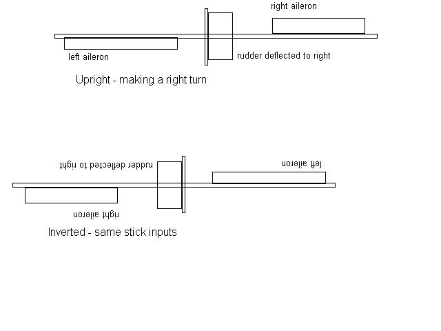

I have seen the coupling info on the 1st u.s. r/c flight school web site.
I have neurological issues that make it virtually impossible for me to use the rudder. Because of this, for safety reasons, I will always be flying on the end of a trainer cord.
My 'buddy box' is a 6 channel computer radio. Since it can do aileron/rudder mixing I decided to experiment with it. I set the mix at 100% to replicate the 'Y' situation.
My modified PT-60 (tail dragger, no dihedral) flew almost the same with or without the mix. It actually did better rolls with the mix. If I held aileron too long, or banked too steeply, getting into a turn it would push the nose down. My Big Stik and Uproar do not like the 100% mix. The Stik makes coordinated turns with 5 or 10% and the Uproar does fine with zero.
My transmitter doesn't have the ability to put the mix on a switch. It's always on or always off. The mix works against you when flying inverted. Maybe inverted flight is not something beginners are doing the first day or two, but we all try it sooner or later.
I disabled the mix after a few flying sessions. It is fun, and OK, to try different things.
Perhaps, perhaps not. In designs from long ago, there was a type of model known as "Class II" which was controlled by rudder, elevator and throttle. On these type of airplanes, right rudder would make the airplane turn to the right even when inverted (with the rudder hanging to the left side). This was due to the effects of the rudder yawing the airplane to the left, but the dihedral effect rolling it to the right.
Old 08-10-2008 | 11:20 AM
carrellh's Avatar
Joined: Mar 2003
Posts: 6,544
From: Garland, TX
Default RE: coupling rudder and ailerons
I will admit that I did not try the mix on every model ever designed. I tried it on three planes and drew a conclusion based on the fact that all of them acted the same, so, my blanket statement is flawed.
Aileron/rudder mixing MAY work against you while flying inverted.
