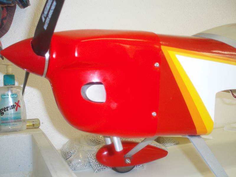

Hey guys...another question. I am building a Venus 4o with an OS 46ax. Looks like I will need to use a Pitts Style muffler in order to mount the engine on its side. Is there any real difference between Bisson and Slimline? Will I be dissappointed in the loss of power(so ive read) compared to the stock muffler? Any suggestions/tips would be appreciated. Thank you!!!

I mounted my OS 55 sideways and used the Bisson muffler.
http://www3.towerhobbies.com/cgi-bin...?&I=LX8680&P=V
You will need to cut the crap out of your cowling. As I am sure you know, the Venus is designed to have the engine mounted inverted. I will post a pic, if I can find my wife's camera. I also have the same muffler on a OS 46 AX on my mustang. Both run just as good, if not better, than the stock muffler. One thing for sure, they SOUND a lot better than the stock muffler!

Here are some pics, if I can get them to load. You can see what I mean about cutting the cowl. The Pulse had the 55 which needed an extension with the stock muffler. The Venus might need the same, if using the stock muffler. One thing about the 55, it does not have the remote needle valve. The mustang has the 46 motor with an allen wrench for adjusting the needle.

Heh, you've illustrated succintly WHY I mount most of my engines inverted.
It's painful to be faced with that much cutting...
