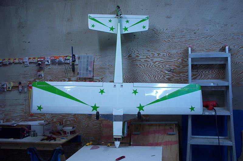

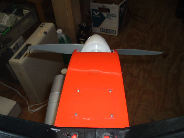

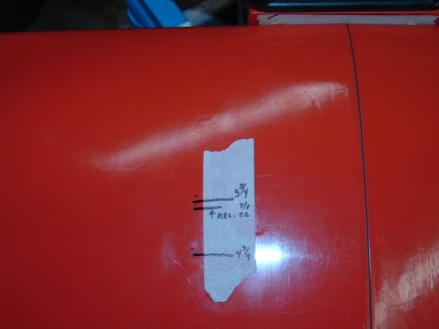

I'm tring to balance this plane. The manual says the CG is 3 3/4 to 4 3/4 inches back form the leading edge. I marked the wing at 3 3/4 and tried there not even close. I 've read a lot of comments about these planes being tail heavy and mine is no different. I have the battery and receiver as far forward as possible. I added some weight to the front of the plane , just some lead I had laying around. After two pieces about the size of a acorn I got it to balance at about 4 1/2 inches. I'd rather it balance at 3 3/4 or 4 for the first couple flights to see how it handles. Any Ideas on what to do. I was thinking about cutting a hatch under the gas tank and putting the battery there, that would put it foward about 3 1/2, 4 inches. Do you think this would be worth doing or should I just add the weight?

Be careful, and check 2x, but go ahead and add weight until it weighs in at the front cg point. The worst that can happen is it will land a little hot with the cg too far forward. As you get the cg toward the rear, it will get sensitive to the elevator. Only you can tell what is just right for you, and that will change a little as you get familiar with it. With the cg too far to the rear, it won't land for you at all. I use the ability to roll axially as an indicator that the cg is good. Also, when you are inverted, how much down elevator you need to maintain level flight is another indicator. If the cg is nearly spot on, you should need very little.

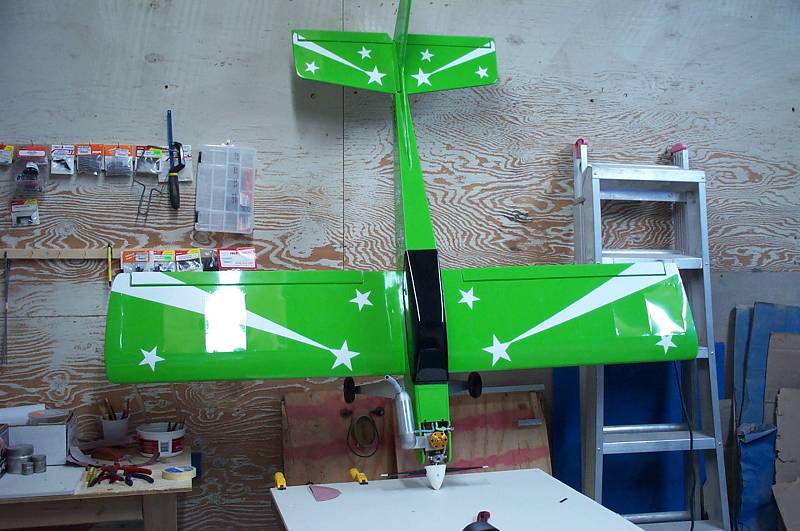

I balanced mine in the middle of the recommended range. I added a fair amount of weight to the compartment under the tank. My Tiger 60 weighs in at a tad over 9 lbs. Heavy but flies awesome with a TH .75. It will even outleg my brothers 4*60 with a GMS .76 and 7lbs.

There is room under the fuel tank for a four cell flat pack however this was still not enough for mine. I had to still add 3/4 oz to the nose to get it center of the recommended CG. After some time on the plane I took all of the weight off of the nose 1/4 oz at a time. I really like the way it flies with the CG futher back than center. I am not sure exactly where it is but I like it where it is at.

I've managed to get two A123 cells in series under the fuel tank on mine. With an OS .75 AX on the front, and a custom built cowl, it came out balanced about the center of the range without adding any more weight.
