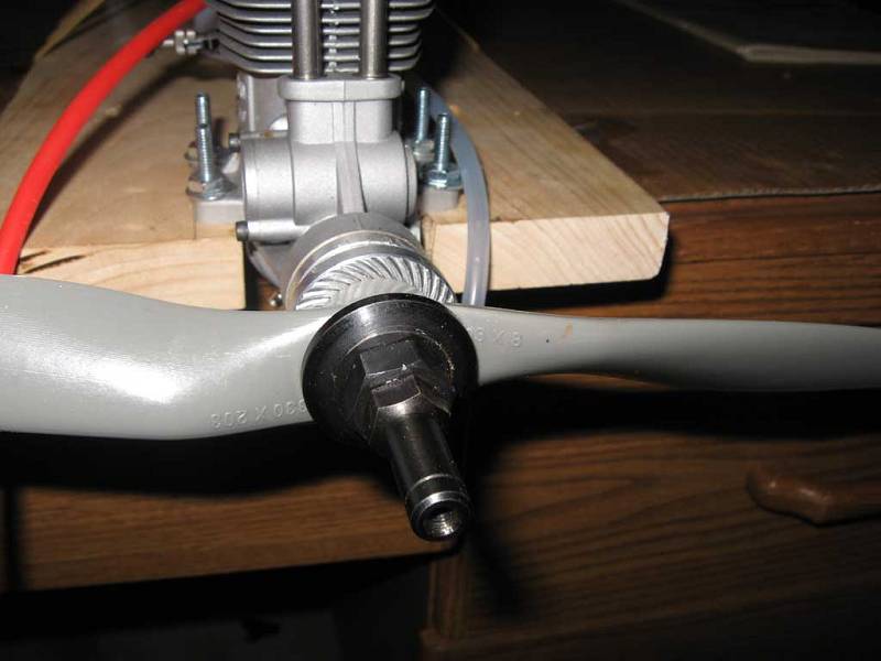

I built a stand to test my engine with, pictures below. No, I'm not going to test it on my desk I plan on screwing it down to the airplane test stand at the field tomorrow.
Does everything look okay? I haven't yet cut and connected the fuel and pressure lines because I had another question.
What is the fuel nipple for on the bottom of the crank, the one I have an arrow to in the picture?

Yes that will work fine. I do the same drywall screwing to the tables at the field.
The hose fitting is a crankcase breather you don't need to put anything on it or perhaps a short hose to lead drips outside the airplane.

I used that exact setup to break in my newest Saito 100. It worked fine, although that knotty pine is quite soft and you will have to pay attention to the tightness of your mounting screws.
That nipple on the crankcase is just a vent. Leave it as is, or you can put a short piece of fuel tubing on it to direct the oil spray away from your plane once you do the permanent install.

The nipple you speak of is not a fuel nipple . It is a vent for your crankcase. It allows air to go in and come out when the piston goes up and down. Some times lub oil will come out this nipple. It is shaped like a fuel nipple as fellows generally use fuel line to lead this excess oil outside of the cowl, or engine compartment.
One thing that concerns me about your pictures is your choice of prop. I can't be certain, but the hub on that prop looks a lot smaller than the drive washer on your engine, almost like it could be a prop for an electric motor. I would make sure that it isn't an electric prop as they are not designed to withstand the power that a glow engine can exert, and might fly apart.

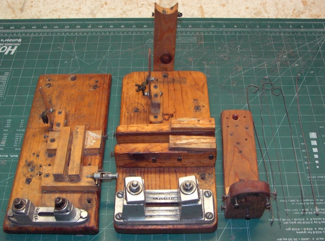

Here are are three of mine that have had a lot of good service over the years:
ID:	1028443   Click image for larger version

I would go with a harder wood such as maple or oak. I once tried plywood and it did'nt make it thru 1 tank.
That does look like an electric prop.[][]

Well, I used the test stand today and it worked great! The engine ran like new.
