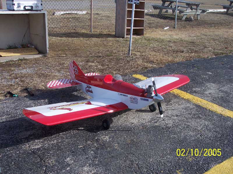

I was considering building the SlowPoke as a 3rd plane, has anybody had any experience w/ this particular kit ? Any opinions would help. I also am open to other suggestions if you think theirs a better plane out there. Thanks.

I think that this is an excellent kit to build, as well as a good 3rd plane. I have a Slow Poke 40 with an OS 52 Surpass on it. This is one of my all time favorite planes. Mine has well over 500 flights on it and it still goes to the field with me all the time. The only bad habit the plane has IMHO is that it's got a small bit of adverse yaw when turning with the ailerons. But coordinating the turns with the rudder will take care of this. I have a mix in my radio to do this for me, but I've done it manually in the past as well.

Ken: I have never had one but by looking at you pics of it, Slow Poke. It has to be the most close coupled plane I have ever seen. Correct me if I'm wrong but my experience has been, long moments, nose and tail, increase longitudinal stability which makes for nice smooth flight. Short moments do make it highly maneuverable but touchy therefore not a really good 2nd 3rd plane? Of course there are always exceptions to any rule.

This one is the exception to the rule. Yes, the short coupling does cause a small bit of adverse yaw, but it's very easy to deal with. But this slow flying characteristics of this plane make it great for newer pilots. Plus, you can open it up and throw it around the sky and have a total ball with it. There's a reason why mine goes to the field with me almost every time I go out!!

The close coupling does add to the twitchiness, and that may make some folks feel a little uncomfortable at the sticks. The main wing will tend to start flying before the tail lifts, but it's not too difficult to deal with once you get used to it. The SlowPoke is definitely not well suited for long, sweeping maneuvers. Rather, slow flight, quick turns, and tight loops are more its specialty. It doesn't roll the fastest, but enough to get you out of trouble anyway. Stalls on this plane are real easy to get out of, as long as you have enough altitude. The nose just drops strait down, abruptly, without spiraling and then lifts back up right when the wing starts flying again. Make sure there's enough weight at the nose, or it won't fly any other way but inverted (done that once with mine). When landing, just keep everything level and touch on the mains. It'll float right on in just by regulating the airspeed. You should do fine with the SlowPoke, TakingFlight96, since by now I assume you've had a reasonable amount of flying experience. It will make you proud, having something that you built from a kit rather than an ARF.
