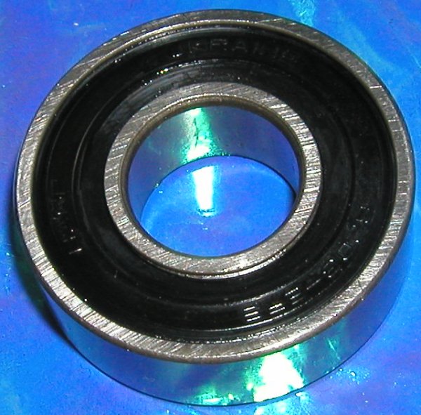

I did mark the rod before disassembling the engine. Since there were marks on the crank case noticeable when the engine was apart, this would indicate the rubbing was occurring before I took the engine apart.
I've got a shielded stainless bearing from Boca. Different from what now comes in the OS engines, but the same as they use on some other, more expensive engines (this recommendation came from some very experienced pattern pilots, one of which is an OS rep, to use the shielded bearing). The engine came with a shielded on the front and an open in the back. Apparently there is a short life span of OS rear bearings.
I called Hobby Services and they said to send it in, that there must have been a machining error and that the rod should not touch the crank case. I think this is what I'll do - it's under warranty and I'd rather not remove material from the con rod, and plus I just got a NEW VENUS 40 to play with while the VII is down for service
Could it be that the noise you heard was the rod rubbing the crank case?
How is the crank pin to rod fit? Is it sloppy? Does the crank pin look bent?
Could a bad bearing have allowed the crank to wobble and caused the contact?
What is the lubricant content and type in your fuel?
Did you over speed the engine at any time?

does the new Boca Bearing you got look exactly like the one you pulled from the engine?. I used Boca on my last rebuild and they were different and I had to pull the sheild off the front and the rear had no seals, Boca said these were correct but OS said no way?? I didn't worry about the rear bearing but the way the front bearing was sealed made the engine run real hot very fast until I opened up the engine again and removed the seal. Just wondering if your bearing looked just like the stock one you pulled?

Well thanks guys - I have to admit I felt silly sending back a new engine with such a slight amount of contact, but I agree, the rod simply should not be rubbing on the crank case.
The rod appears to be in great shape; not bent, nice snug fit with the shaft. The noise is definitely from the old bearing, which has quite a big of play in it. The noise stops with the new bearing, though contact remains. Using 10% nitro fuel with 20% lubricant, 18% synthetic/2% castor. Top RPM achieved was 9000, though only for a flight or two then switched props and got 8000.
As far as bearings go, Boca was going to send me the high speed steel bearing, open at both ends, which is what's in the engine originally. Some top pattern contenders told me they all go bad after a hundred flights or so, and that most guys running OS 120-160 engines in pattern go with the stainless Boca bearings, and get 300+ flights out of them. My front (stock) bearing is covered - don't know the difference between sealed and shielded - it has red plastic or rubber covers over the balls. The original rear bearing was completely open, the new one has blue rubber or plastic covering, again as recommended by talented and experienced pattern pilots and an OS rep.
If I get a new engine or new bearing, I'll keep the bearing in it until it goes bad - we'll see what happens. After 30 flights the bearing is discolored, making noise, and wobbly, and I use after run and take care of my engines.
Shielded bearings have a metal piece rather than the plastic seal that is intended to keep contamination out. I've found that these are generally pre-lubed also but the lack of a good seal means that light lubricants can flow into or out of them. Most RC engines have a metal shield on the outside of the front bearing to minimize air leakage and to help keep debris out of the bearing.
Personally, I think the rear bearing on an RC engine should be an open type. That way it gets the benefit of the lubricant in the fuel. Typically you only see open bearings in things like engines and gearboxes where they receive good lubrication and are protected from debris and moisture. Yes, a sealed bearing might work but I would think that its life would actually be shorter. Maybe I'm wrong, who knows.
As long as you use good fuel with plenty of quality oil and don't allow the bearings to corrode, they should last a long, long time. Of course that also means no excessive RPM, no excessively lean mixture and no overheating.
