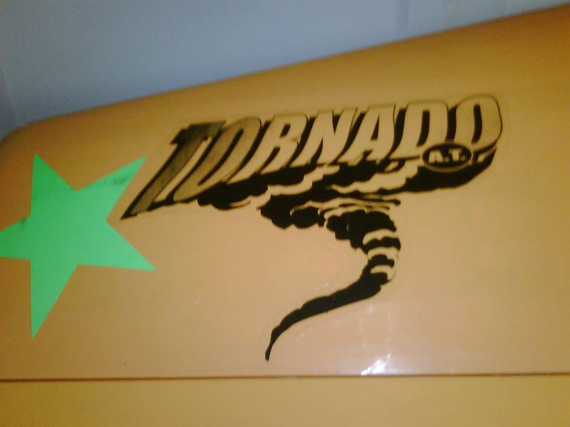

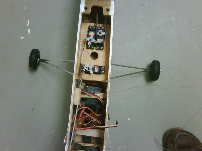

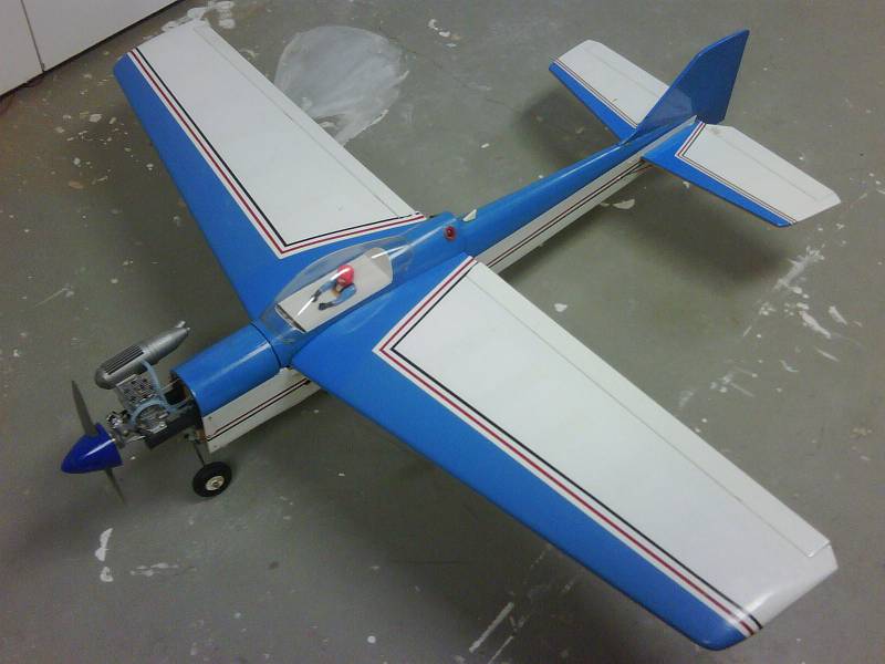

Hello,
I'm new to all this but my neighbor has been doing this for a while and he tells me that we need to figure out the CG. Can you guys help me figure out what this plane is and if somebody has or knows where the CG is it would most appreciated. What I know about the plane. We think it's a .40 size. We put a ThunderTiger .46 engine.

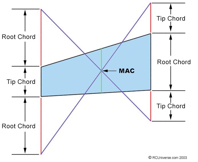

The first thing you need to do is to find the Mean Aerodynamic Chord (MAC)
To do this, follow the diagram below.
Once you have established the MAC, figure approximately 25 - 30% of the MAC for CG. This will give you a good starting place where a good pilot should be able to fly the plane.
Once flown, you can determine if you want to move the CG forward or back for your specific flying style.

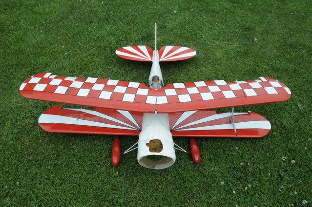

How would this apply to a bipe with a swept wing on top? I'm restoring an old Super Baby Great Lakes and need to figure out the CG.

For Bipes it's basically the same, but you need to find the CG of both wings and average it out.
But I have a simpler method
I just lift the plane from behind the top wing. With your fingers completely under the wing, it should sit slightly nose down. Then fly it and adjust as necessary.

I'll make this short and sweet. That plane is a Tornado,cant remembet the manufacturee but i do know the CG location on it. I have one, the CG is measured 1/2'' back from the leading edge at the WING TIPS! If you make marks on each tip at these points and draw a straight line from one tip to the other,you get the CG location at the fuse.
They fly great to.
That should help you out with the Tornado,as to the bipe,all you need to do is take the measurement of the wings cords ( from leading edge to trailing edge) and take 30 to 33% of the cords as you starting points.
Example == top wing measure 8 inches , 33% of 8 is roughly 3 inches.
bottom wing measured the same way
Now measure the distance the top wing is in front of the bottom wing from both wings trailing edges. You can then cut that measurement in half ( if 1 inch,use 1/2 inch as starting point)
With that measurement you can now safely set you CG by the 33% figure of the bottom wing by moving it ahead 1/2 inch.
This formula will give you a safty margen for you CG as it will make the plane a bit nose heavey i have found using this method over the years. You can adjust the CG to your comfort level of flying as you get used to the plane.
Hope this info helps you out!
Good luck flying, Art

Hey Thanks so much will try it out and let you know. We had the CG measured out at about 4 1/2" from leading edge and it wasnt flying right at all. My budy almost crashed it a couple of times. That should make a big diffrence.

Thanks again just so I understand I put the wing on and then from the leading edge on both sides of the wing tip measure 1/2" down and then at the intersecting point on the fusealage that's my CG?

Yes,you measure 1/2 inch back ( toward trailing edge) from the very Tip of the wing. The draw or use a piece of string taped across the wing from these marks. Where the string crosses the fuse is your CG POSITION AT THE FUSE ON THE WING.
