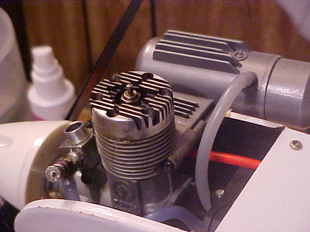

Default Heres a pict.
here is a picture of it, checked all the bolts and screws and all are tight. I will pull the carb next and check the O ring.
Can anyone I.D. this motors mfg. for sure?

Old 05-26-2003 | 02:21 AM
Live Wire's Avatar
Posts: 6,059
From: Sterling , CO
Default Rigging A fuel tank
It is a tower motor not OS and has a air bleed idle and they are hard to set! The screw on the right side of the engine skews in and blocks the hole in the front of the carb. This hole will be almost closed to get to idle. You must also have good compression with carb.
