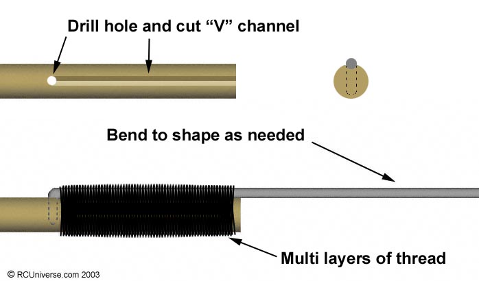

A guy built me a debonair as a gift, all its needed is an engine and radio equipment, it calls for dowel control rods, how do you make em and is there an advantage over normal control rods?

"Normal" control rods were dowels in the past, they are very thrusty. You only have to cut them to the necesary lenght, make a hole to insert part of the wire rod, glue the parts and add a shrinkable tubing.

Old 10-05-2008 | 07:48 AM

ORIGINAL: alfredbmor
"Normal" control rods were dowels in the past, they are very trusty.
I was going to say the same thing.
Just drill a hole about 1 1/2 (One and one half) inches from the end of the dowel, then cut a "V" shaped notch from the hole to the end.
Make a 90° bend in the wire 1/4" from the end and insert that bend into the hole so the rest of the wire rests in the "V" groove.
Now wrap the hell out of it with plain ol' sewing thread, then smear some glue on it (Wood glue, CA, or whatever you like - I like thin CA but it makes a lot of fumes)
Do the same to the other end. Then bend the wires however you need them.
Note: you'll want to measure how long it needs to be before starting. If either of the wires has no threads, leave that one long so you have room to "cut to size"

1/4" or 5/16" dowel pushrods are fine when put together as Minnflyer shows. You can also cut a strip of covering to replace the shrink tubing and iron on a couple-three wraps if you don't have heat shrink tubing available. The only thing to watch for is the grain of the dowel is straight, otherwise the strength could be comprimised. For smaller lighter models (below 40 sized) 1/4" square balsa works well if firm and also staight-grained.

ORIGINAL: HighPlains
1/4" or 5/16" dowel pushrods are fine when put together as Minnflyer shows. You can also cut a strip of covering to replace the shrink tubing ...
I also may apply CA under the heat shrink as an added measure. By the time I do this I KNOW the dowels are of the correct length.
