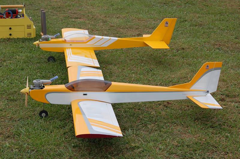

I`ve been flying for a couple months now, my main outdoor plane is my trusty FlyZone Sky Fly and I`ve soloed on that and my parkzone ember, and I can fly both pretty well I have experiance with 4 channel planes though most of it is in simulators, however I feel quite confident with my skills and I`m not sure where to go from here, the Sky Fly is a beginner plane and the Ember is an intermediate but they`re both three channel, I`m not sure whether I should go to a low wing (not a aerobat or stunt plane) or a high wing trainer, I want to move up and I know that I can, I`m just not sure how fast to, basically, I want to know if I can save a few bucks and go directly to a low wing.

Default RE: Not sure where to go
ORIGINAL: drZoidBeRg365
If you know that you can move up, you got half the battle won.
Can you go directly to a low wing? You betcha. If you go to the right one, you'll be an odds on favorite to succeed.
The Tigers are excellent models. They also happen to be very, very good trainers. They just happen be low wing. Super Sportsters are very good. The new GP Cherokee is a very good low wing and looks less like just a model and more like a fullscale. Four Stars are good, but their wing construction is a bit damage prone (not full LE support). The Calmato Sport is as good as any of the above.
