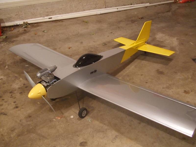

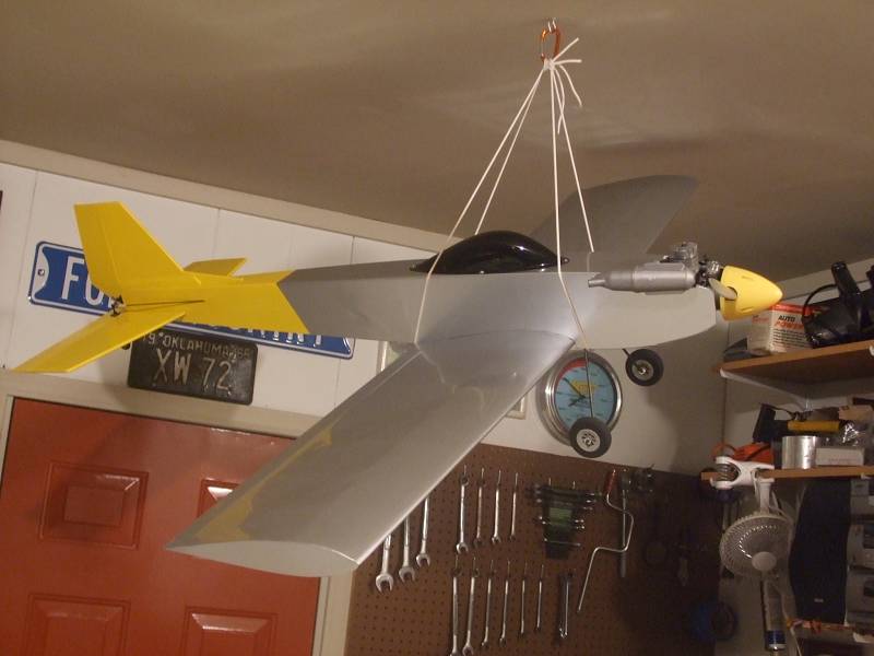

I love the world models skyraiders, but they sure cover them with some ugly "toughlon". It's really just the wings that are ugly, but you get my drift. I set out to redo this one completely except for the factory yellow which I thought would look good on there. I used Ultracote silver, and I think ultracote is my new favorite covering. It's super easy to use and my LHS carries all of the colors. I still don't know what kind of markings to put on the plane, WW2 warbird stickers or give it the raceplane look. I'm also thinking about installing retracts, if they will fit into that wing. Ya'll let me know.

you were right the wings did need to be recovered. I dont care much for the factory covering job they put on this plane. I did the same with my tower uproar. I stripped the wing and recovered it. The plane looks good Brett post more pics when you finish it.
Does look nice in a different color, and the covering should hold up a lot longer than the factory Toughlon covering.

Forget about retracts in it. There is not enough structure in the wing to withstand any type of landing gear, let alone retracts. Plus you have the weight gain from retracts that will ruin the fun flight characteristics of the design.

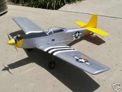

Looks good. I'd buy some WW-2 military decals. After all it is silver with a yellow tail similar to some Mustangs. Just be careful with the gray and silver colors, they can disappear in the sky really easy under the right conditions. They can for me anyhow.
Retracts wouldn't be impossible but I'd definitely beef up the wing. There is no structure there at all to support even fixed gear. If you like the WM planes, take a look at the Rambler 45. It flys great and comes with factory installed retracts. I've been in the process of re-covering my Rambler for a few months. Other projects just seem to get in the way. Eventually it will be Cub yellow and purple.
Also, flip your main gear around so it angles back instead of to the front. It will make the plane nicer to land. I did it on my old Mach-1 and it worked well.

Brett, here's an example of the silver/yellow Mustang I was talking about. One is a 1/2a kit I built a few years ago and the other is a H-9 Mustang.
