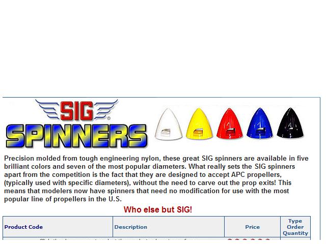

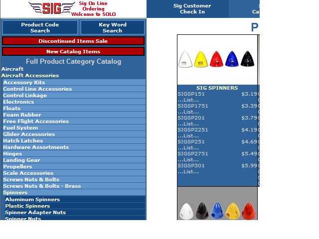

SIG spinners are supposedly "Cut to fit APC props." Which prop, who knows? They might be able to tell you if you call them.
http://www.sigmfg.com

I like Tru-Turn spinners, and have a few. But, nylon spinners are 4 dollars and my cheapest TT was 30 or more including the adapter. I have no problems with cutting up a nylon spinner. I just wanted to point out the there are nylon spinners available that claim to be made for APC props.

Thanks carrellh, looks like Sig might be the ticket. I`ll give them a call to verify that their 2.25 spinner will work. For some reason I never really realized that APCs don`t match up well with most spinners.
