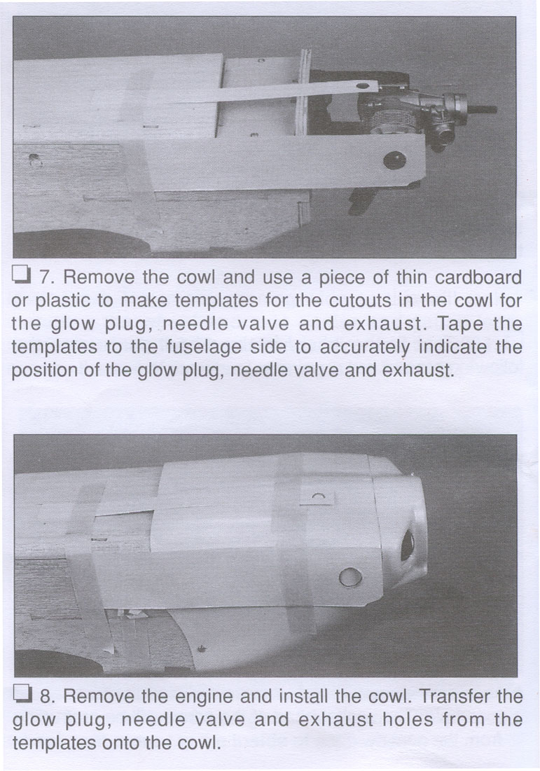

im getting ready to cut out and put the cowl on a older model hangar 9 232 breitling its my first time doing this and im kinda of afraid of screwing it up ! i need a few pointers or do's and donts on getting everything lined up right!
Use cardboard templates.
Cut long strips of cardboard and use them to fine tune the openings that you'll need. Then, with the engine in place, tape the cardboard onto the fuselage with the openings you cut around their corresponding engine parts.
Now, remove the engine but not the cardboard strips. Put the cowl in place and trace the openings in the cardboard onto the cowl.
This will get you close if not dead on. I'm sure somebody out there has some pictures of this.
Cut in small increments and work toward your traced lines. It's easy to remove more material but impossible to put it back.
Be sure to have a good air outlet to keep the engine cool also. I think the general rule is 3 times the outlet opening as the inlet? Someone correct me if I'm wrong on that.

That is exactly the same way I do it but I use construction paper or poster board from the dollar store (dollar stores are a great place to pick up hobby supplies
I mark the cowl with a sharpie.
I use a dremel with a small and large sanding drum to cut out the cowl and work the holes to size (do this outside or in a garage, there is alot of dust, wear safety glasses)

One picture is worth a thousand words. I give credit here to whoever originally wrote this and published it, I found it helpful, so I saved it.

how far back do i need to go with the cowl on the side of the fuse before i start? the cowl will fit over the whole engine easily without doing anything as it is now im just not real sure how to determine where to place the cowl before starting im thinking just back far enough to where it looks right with the shaft coming out
Technique One
First go ahead and mount the engine in place at the recommended distance. Leave the muffler off.
Sometimes I may also need to remove the HS needle and carb too!
If possible slide the cowl into place.
Then put on your spinner and prop.
Align the cowl to the spinner leaving the proper distance from the cowl to the spinner.
Now mark the position of the cowl on the fuse with a panel line pen ( you can remove the marks it makes with alcohol easily! ).
Remove the cowl and engine and use the alignment lines you drew to make the screw holes.
Technique Two
If I cannot slide the cowl over the installed engine...
DO NOT worry about making the cowl screw mount holes at first.
Mount the engine on the plane, and make your cardboard cutouts.
Remove the engine and slide the cowl into a rough position. Put a ruler or other measuring stick in through the front of the cowl to get an approximate distance for cowl mounting.
Make temporary alignment marks on the fuse.
Now start cutting the holes you need to be able to move the engine into it's final position.
Put the engine back on and see if you can get the cowl into place.
Keep working on your cowl holes, e.g. the cylinderhead hole, etc. until you get the cowl to slide in place.
Once done, put the spinner and prop on the engine. Align the cowl to the spinner, and mark the position on the fuse...
Sometimes when I am this far along I tape the cowl to the fuse and go ahead and drill the cowl mounting screw holes, as I now KNOW where it should finally rest...
