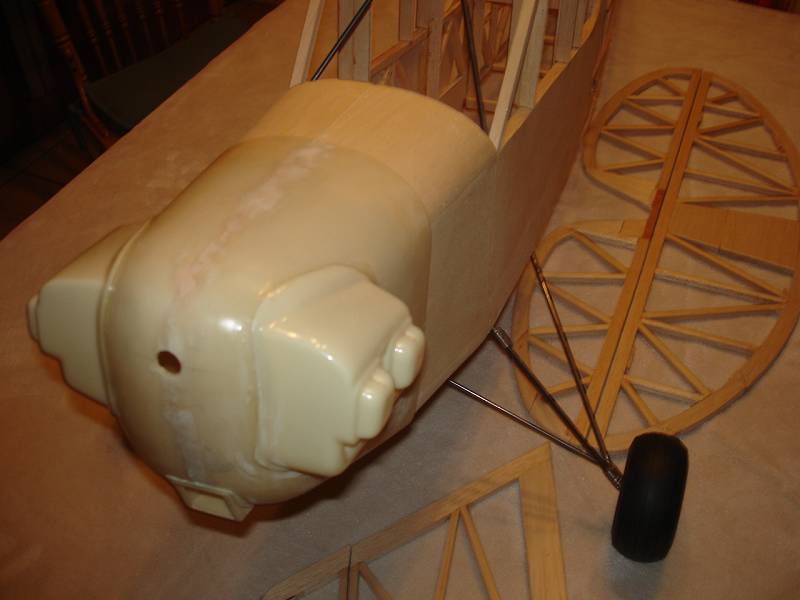

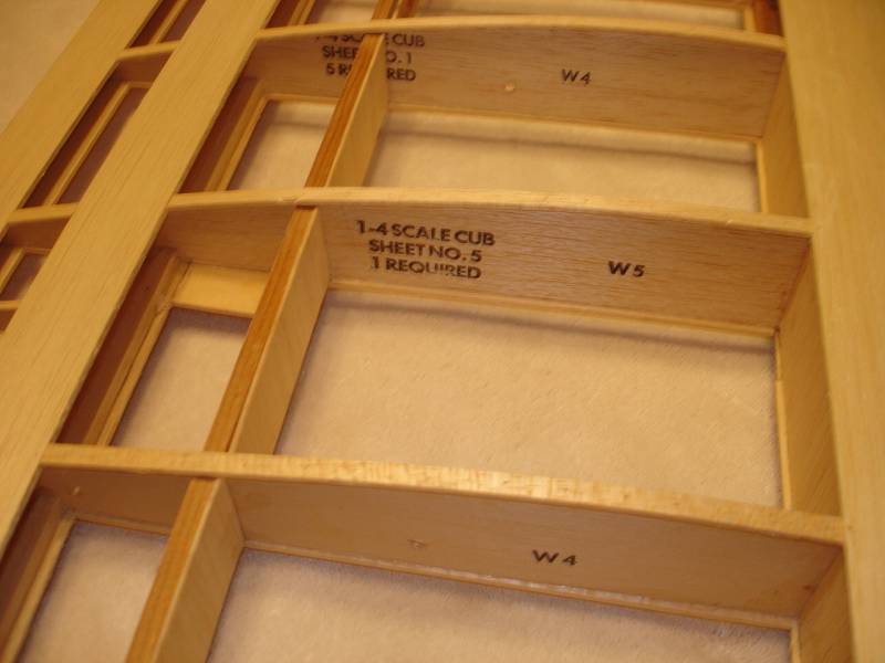

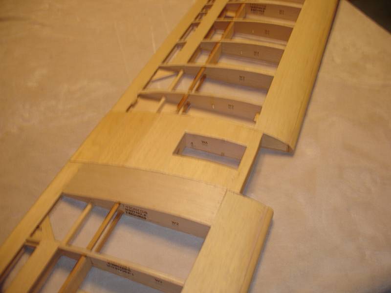

I will post some pictures and maybe someone can tell me who makes this plane. I need the window kit. WS-85" fuselage approx 60"
Old 11-09-2008 | 06:33 AM
goirish's Avatar
Joined: Dec 2005
Posts: 5,130
From: Litchfield, MI
Default RE: Engine for 1/4 scale Cub
Here are some picturesSee who can guess the mfg. Hope you can. I would not let me upload 7 pictures.. If you need another view let me know and I can do that

I would say you have a ¼ Sig clipped wing cub

The old gentleman I purchased it from (who had a stroke) said he though maybe it was a Sig but he wasn't sure. Do you know where I might get a window kit for it?
