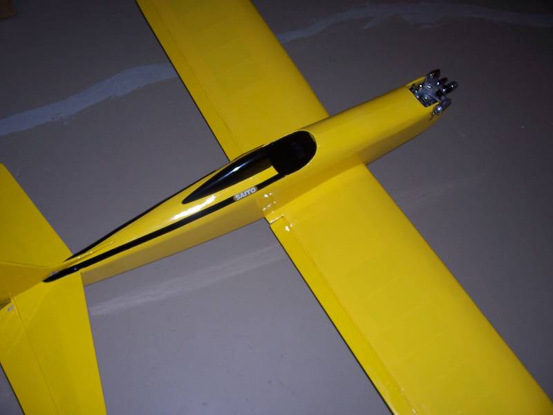

Hello
I began building the Astro Hog a few months ago. I just finished the fuse and mated the wing to the fuse by drilling holes for the dowels. I thought I had followed the plans strickly until I mated the wings. I noticed that on one side of the fuse where it meets the wing it does not butt against that former leaving a 1/4 inch gap. If I buttted it the wing would be crooked and not line up with the back of the fuse. Is this a concern? I am not sure if I installed the dowells incorrectly or if the fuse is just not straight. Will it fly inncorrectly? Thanks for any help.

This is really not that big of a deal as long as the dowel is long enough to go into the hole.
What is important is to make sure the final wing mounting is as square to the fuselage as possible.
You will need to collect some information, this is just so you will know where the problem originated from, it won't affect what you need to do to fix it (unless you intend to tear the plane apart which is not necessary).
Get a small square and see if the former where the wing dowels mate is square to the fuselage on both sides.
Check the former at the back of the wing saddle too.
Check to see if the leading edge of the wing is straight. Maybe the leading edge was sanded more on one side than the other or when the wing halves were joined there is a small misalignment.
Using the center of the back edge of the fuselage as your reference set the wing in the wing saddle (dowels in the holes) and adjust the wing so the trailing edge of eacc wing tip is equal distance from the reference.
This will align the wing to be 'square' to the fuselage.
You will now drill the wing bolt holes so this alignment is maintained.
If the gaps (where ever they may be at this time) bother you, just glue in some scrap balsa and sand as required.

I would make sure the fuse is straight. If not it will cause the vertical fin to be out of alignment and would need alot of trim to fly. If the fuse is straight then what I would do is make sure each wingtip is the same distance from the rear of the fuse and bolt it down there. 1/4" gap doesn't sound like much and probably is not for some people, especially on a repaired plane, but for some reason I like to make sure all of the measurements are within a few millimeters. A straight plane flys better. Also a couple of pics would help diagnose the problem.

I want to thank you for the advice. I fix the problem and dowells were the culprit. She is looking good.

She is done and ready to fly hopefully this weekend. She has a Saito 82a and 2.4 Futaba FASST.Thanks for the comments and help.
