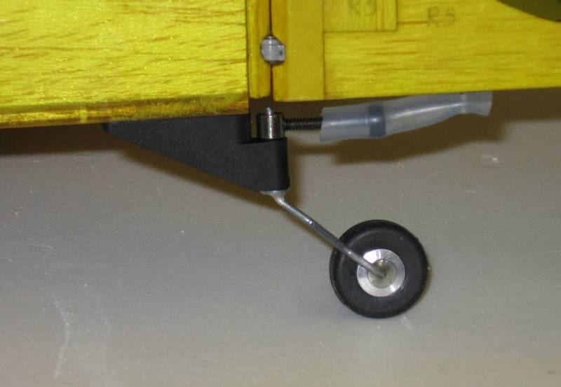

Here's a light and simple option making use of the Dubro bracket. A cap screw does double duty to capture the wire and serve as a flexible means of connecting the wheel to the rudder. The silicon fuel line is surprisingly resistant to tearing but will let go in a violent "arrival".

What size set screw did you use? Did you have to re-drill and tap to make larger or just get a longer set screw?

If I'm not mistaken, it's 4-40. I just poked around in my junk box until I found the right size.
