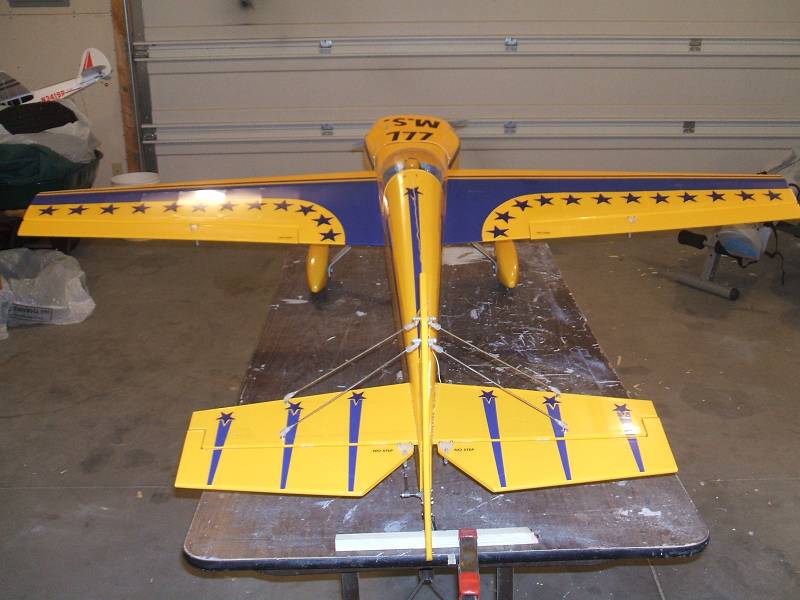

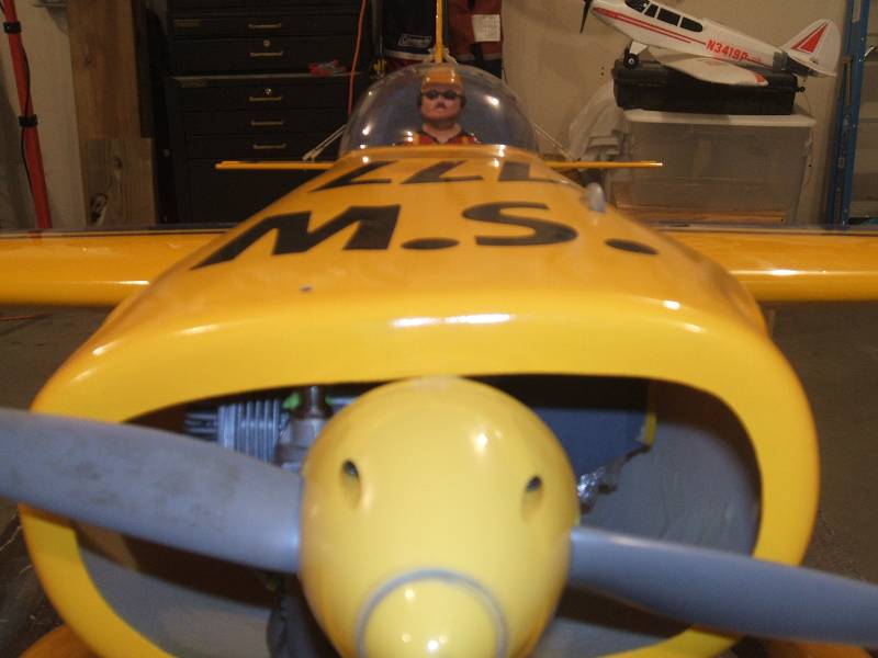

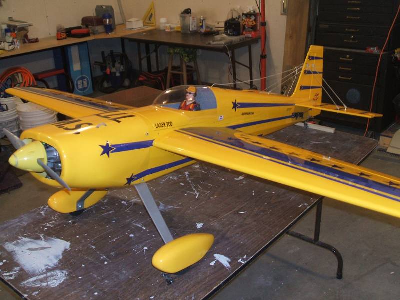

I just recently purchased a plane from a guy and it has the SK90 two stroke engine on it. I filled the tank and began to prime the engine by holding my finger over the pipe and then tried to start. I am using my finger (chicken stick) to start. I was wondering if this engine is unable to be started by hand or do I need to purchase a electric starter. Well after trying a couple times my arm hurt and I noticed a little puddle of fuel on the ground under the pipe. Is the tank and or some lines screwed up or did I just flood the crap out of it. Please help I am wanting to get this started. Also what type of fuel do you suggest to run in this engine. Well yah I am a beginner sorry for all the questions. Thanks for the time and hope hearing from you.

Please don't use your finger. Use a piece of broom handle or something. It will start easier with an electric starter, but will start with a chicken stick. Make sure your ignitor is charged well. The fuel coming from the muffler could be excess from the vent line to the muffler after filling the tank. 10% nitro 18% oil will work well with engine. You can take the glow plug out to see how wet it is to see if the engine is flooded. Also, while the plug is out, test the plug with your ignitor to see if the element glows bright.

Thanks for all the help with the engine problem. Looks like I am going to have to invest in a electric starter. Gray Beard I was wondering if you were happy with the SK90? And also I was wondering what size prop you are running on it? Well it says a 13x8 but on this plane it doesn't look big enough with the cowl being that big to be able to pull the aircraft? Well I know everybody says I shouldn't fly this for a beginner but I have been spending a lot of time on a simulator (real flight g4.5) and I have heard that its very realistic to actually flying. I have found that I can fly my particular model better than the so called trainers. I think I am going to try to fly this one with a very experienced 3D flier on my buddy cord.

The SK engines are so good and the design is about everything I was looking for in A two stroke I have given up using anything else. This engine is designed to be A high torque engine with lower RPMs so it is about perfect for that laser you have. DON"T TRY TO FLY THAT PLANE BY YOURSELF!!!!! There was A bit of A miss print in the instructions about props. The 90 requires a 15X6 or larger, A 15X6 is A good one to start out with then you can start that magic search for the perfect prop for YOU. I say you because there is no perfect prop, it's the prop that keeps the engine in it's working RPM range and will fly the plane the way YOU like the plane to fly. I have had the SK .90s in A 60 size Aeromaster bipe, A 60 size Kaos and A rather big for A 60 size Extra 260, sort of like your Laser. A 15X6 or 15X8 is my prop of choice. The 16X6 and 16X4 were also good. I keep the engine around 11,000 rpm or there about. It's A stump puller and at 100 bucks I found it the best engine on the market. That is the best two stroke engine for me, there are A lot of other choices out there that fit other people A lot better. That 13 inch prop will make your engine run lean and you will never get it in tune. I have never run the stock muffler on any of mine but that is just because of the planes I have had them in.

Thanks for all the help and I am glad I asked about the prop size I thought it looked a little to small on there. Well I have the plane up for sale on the RCU market place. All you need is a radio system and servos for 300.00 or trade for a good trainer. If i don't sell after a couple of weeks I am going to tempt to fly it. I know what all experience fliers are thinking!!! I am not crazy just a little risky. What size cone would I want to use with a 15x8 prop?? Also could you explain a little about the prop second number 15x8 or x6 I am pretty sure I know its the angle but which is going to give you more speed or torque??????

Just measure the plastic spinner you have on it and buy the same size or one you think looks cool. Most spinners you buy need to have the blade section opened up more anyway using A Dremel with A cut off wheel or grinder. The second number is the pitch of the prop, no need for me to get into the way they measure it for you. An easy way to remember your pitch selection is this: shorter prop bigger pitch= more speed with less torque. Longer prop with less pitch= less speed but more torque. I fly stunt planes so I use the longer props with the smaller pitch to slow my planes down but pull the plane harder. It makes for shorter take offs too. I buy A bunch or props of different sizes and test them on my plane to see what works for ME the best. Notice that ME thing, another pilot may like the same plane with A different prop A bunch better. That sort of kills the question I see all the time about what size prop with this engine on this plane. Any number of props will fly the plane very well. Yesterday I broke the only 14X6 APC prop I had, today I'm going to fly the same plane with some odd ball prop I had that will work on that engine. No idea at all if I'm going to like the way it fly's the plane but I know the plane will fly with it. Question, are you saying you have no club close by that may have an instructor to help you out? Most clubs have someone that will and most instructors have A trainer with A buddy box to get you going on the real thing. Even if someone set you up on A buddy box with your Laser you would be ahead of the game.
