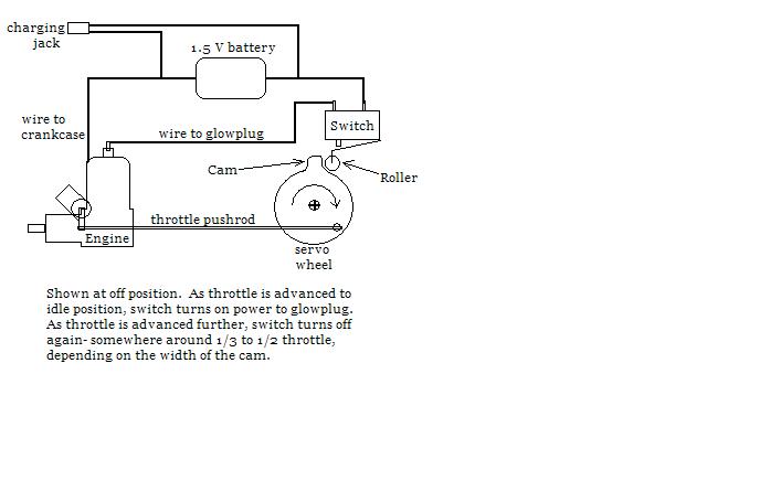

I have an onboard glow starter on my RV4. I want to add a micro switch so that when I go to idle the glow comes on. What is the best way to accomplished this and ifyou have any pictures that would be great.

Yeah,I've seen guys mount a momentary toggle switch or something similar behind one of the arms of the throttle servo horn arm. And when the servo arm is at almost idle it will push up against the switch thus tripping it....as the throttle is advanced it moves away from the switch thus killing the circuit and the power is then off. Pretty simple and radio shack should have whatever you need.

I have built mechanical glowdrivers for a couple of my planes. I used a 'roller' switch from Radio Shack and cut a large servo wheel to have a cam on it to activate the switch. Don't have any photos, but here's a drawing...
