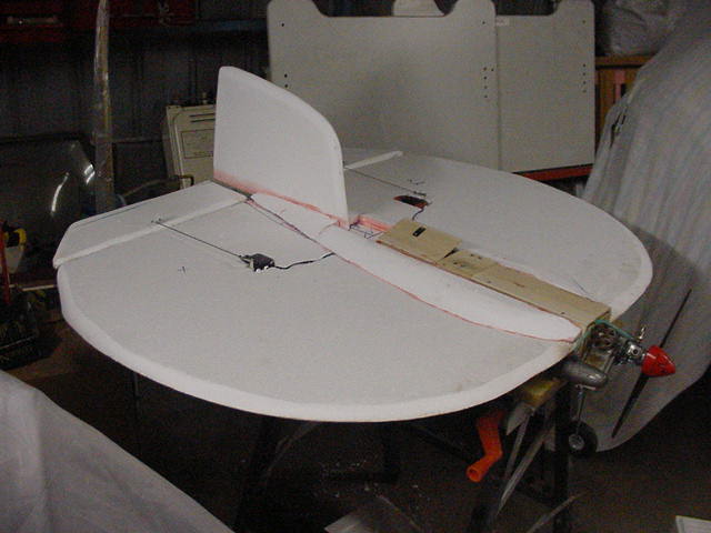

Here's a picture of the mongrel. Hey Downunder, the weather should be clearing up on Sunday, so its gonna be make or break. Hopefully this thing flys like a bird.....and I don't mean a chicken. I'll fly it in a paddock out at Mallala and scare a few cows. But seriously, where do you think the cg. will be? The dimensions are 1100 long and 900 wide.

Wow...I reckon you're going to have a handfull there! Don't forget where the throttle stick is
But looking at it, I'd think the CG should be about where the first joint is on that top sheeting. If you're flying at Mallala then make sure you're about 5k away from the Constellation field. Doesn't worry me cos I don't fly there
but they might get upset if you shoot them down. Actually, seeing you're so close to that field it might pay you to call in there and get someone to check it out. Let us know what happens
30% back is okay for a normal plane but this is a flying wing

I'll second cabanestrut2002's image, that looks about right.
If you want some other references on the CG for that kind of design, look at some of the planes on www.spadtothebone.com Even if you don't like spads, there are several variants on the PBF/DOT/StopSign type design, and you should be able to easily check those plans to get a general concept of where there CGs are.
