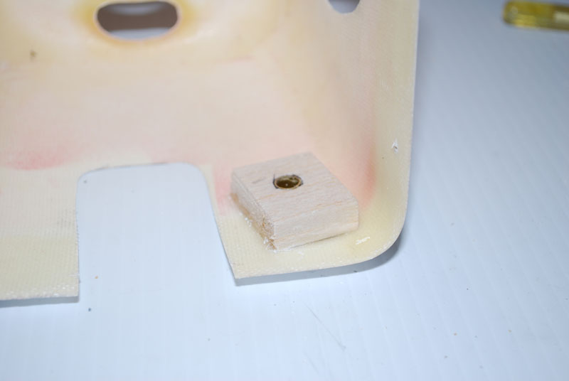

and RCKen; in your review; I try to see how you did the refuel line at the bottom; can you explain how you did that. I would like to see a pic from the inside if thats not a problem.

Ok, what I did for the fuel line is simply make a receptical for the fuel dot to mount in. It's not really a fuel dot, but rather more of a fuel stopper. But it works just like a fuel dot if you build a small receptical for it that mounts in the cowl. These are pretty easy to build. First start with a small block of balsa. I don't remember the size of brass tubing you will need right off the top of my head, but 1/4" tubing seems to stick in my mind. First shape the bottom of the balsa block so that is fits the inside of the cowl. The block only needs to be approxmately 1"x1"x1/4". After it's shaped to fit the inside of the cowl drill a hole through it for the brass tubing. Now size the brass tubing so that it extends 1/16" below the bottom of your balsa block, and cut the top of it flush with the top of the block. Use thin CA to secure the tubing in the balsa. Now drill a hole in the cowl where you want the filler tube to mount. the 1/16" extending below the block should sit flush with the bottom of the cowl when the block is in place. Use epoxy to glue the block in place in the cow. Once the epoxy is dried slide the fuel filler tube through the brass tubing and then push the stopper into the fuel tube. You can then push this back into the tubing and it will secure in place. This can be seen in the pictures in my review, [link]http://www.rcuniverse.com/magazine/article_display.cfm?article_id=1039[/link] . Here is a picture of the block on the inside of the cowl.
Hope this helps
Ken
