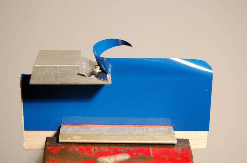

It is useless- save your money. If you want a great tool that cuts a clean 3/32" strip along the edge of a fuselage, wing or tail get the Higley tool. See http://www3.towerhobbies.com/cgi-bin...&P=SM&I=LXL791

It is not obvious to me how the Higley tool is used.
Old 01-08-2009 | 12:38 AM
w8ye's Avatar
My Feedback: (16)
Posts: 37,576
Received 11 Likes on 10 Posts
From: Shelby, OH
Default RE: Trim Tool
Align the edge of the Monokote in one of the slots and the razor blade slits the Monokote as you push tool along
Old 01-08-2009 | 11:13 AM
Posts: 2,065
From: Philadelphia, PA
Here is a sequence to show the tool in action:
1. The covering applied with a flap hanging over the edge.
2. Sliding the tool along like a miniature block plane.
3. Finished.
4. Back side showing the perfect 3/32" strip waiting to be ironed over the edge.
