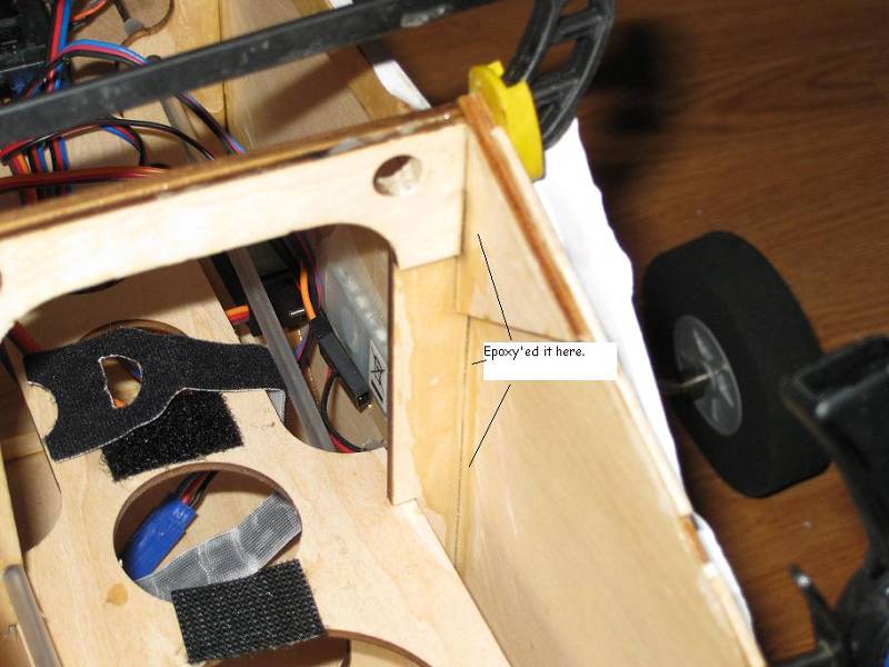

I built the Goldberg Protege after Minnflyer did a review on this plane, I thought I would like it, so I picked one up. The only difference was I used an OS .75 AX instead of the OS .55 AX that Minnflyer used.
Move forward about a year. I went out to the field to fly the Protege. Well, the wind was blowing pretty hard and I was debating flying it or not, but I really wanted to fly. The wind was going right down the runway so, this was a 'good' wind. So, up it went. I flew it for the full tank and landed it. Landing was a real breeze (pun intended). So, after a real greaser landing, I put it down on the ground behind the work bench and went to help one of the other guys with his plane.
Well, no sooner did I walk away, did I hear a loud crash. I turned around and saw my Protege upside down about 10 feet from where I set it.
The wing was ripped off and the formers from the firewall to the wing saddle were broken away from the fuselage. What a mess... but repairable.
Today is a cold and windy day, with a promise of snow, so I decided to take a vacation from chores and get to the Progege and see exactly what the damage was. Well, as I said, the formers were broken away from the fuselage sides.. but they are actually not broken, but the glue that was supposed to hold the thing together just failed to do it's job.
Everything actually snapped together on the fuselage so I mixed up some 30 minute epoxy and put it together again. It's now sitting there on the floor, with the epoxy setting up. I applied some epoxy to all the edges of the firewall and pushed it in with an exacto knife blade so it penetrated into the space between the firewall and the ply covering along the sides and bottom.
Next will be to put the wing back together. That will be a tad bit more chalenging because there are some broken wood parts that I will have to fabricate. Not a problem, I will get that done this afternoon too.
The right wing has a broken length of balsa right at the bolt on spot. The left wing is ok. I will have to fabricate a piece of tapered balsa, perhaps I will get myself a piece of aileron stock from the LHS and just carve out the part where it is broken on the wing, replace it, then "shore" it up with a length of light ply.
All that remains is to fabricate a cover for over the tank out of thin ply and glue it in place, clean up the engine, then take it out to test fly it.

I like the clamps you are using. Do you feel there was a quality issue with your arf?
What is opinion of the original glue joints? Just curious.......Dan.
The glue joints were terrible. I hate to castigate Goldberg, because this is a very nice flying model. It meets all of what I would expect of it, and more. The quality is just what you would expect from an ARF. If I took some time to attend to some of the vulnerable points I may not have had as much damage.. but it was, in fact, minimal, so I really can't complain. I fixed what I thought was a problem, good old Epoxy.. and took it from there.
Those clamps are generally available at Home Depot, Lowes, and Ace Hardware (which is where I got mine). I just took them off the fuselage after making the repairs and it looks solid as a rock.

I just added the final fix, put a ply covering on the top of the fuselage over the fuel tank. I already reinforced the firewall, by the way, I did that yesterday.

What this an ARF? Sounds like maybe the thing wasn't glued together very well to begin with. So in this case, the wind may have actually done you a favor by showing you some weaknesses in construction without completely destroying the plane. That is a fairly stressed area in aerobatic maneuvers, so the thing could have came apart in the air, in which case you could have lost everything, engine, electronics, plane, etc. Look at it as you're lucky you got to fix what was wrong before it cost you a lot of money!!!

Nice repair job and thanks for sharing your story! I would suggest reinforcing the firewall as another gent mentioned. I can't believe CG didn't even put some tri stock behind it to give it some support. I usually drill and pin the firewall from the sides and bottom as well. That's my only gripe with ARF's, poor glue joints and weak construction on lots of the planes. I usually spend about 2 hours reinforcing them before I ever fly them. DG
