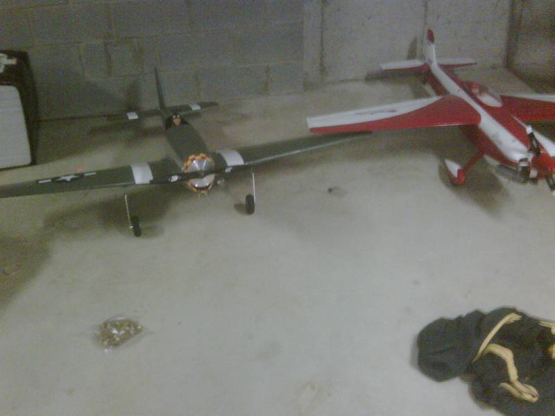

Thank you all fellas, that was very helpfull, yes the battery 12v from H9 was charged a good 10 hours and the glow plug is fully chaged and in the green when connected, I checked the lines just now and they are perfect. I will go tinker with it a bit mroe, I am just debating on just putting in a OS 46 because this engine was used and I dont know how hard. And for my alpha engine not being able to turn over it was a locked piston and Evo is sending me a bran new one no questions asked. I will let you know how it goes in a hew hours after I get it running. Oh btw here are a few of my p-51 pics, just gotta put on rest of decals and spinner, do you know what is weird, the spinner that came with the plane does not fit the saito 100, the hobby shop said we can drill out the hole a bit or get a new spinner size, but then I wont have that nice yellow and red detailed spinner. I could aways go with an aluminum one but what would you do?

If the hole in the spinner back plate is too small, just ream it out.

Ok thanks Chuck, that is what I made my mind up to do rather than bu an expensive tru spin spinner. then I can use the same spinner, also does anyone know who sells a spare set of deal sheets for the p-51 I messed the bottom air force wing sticker using a not so sharp exacto knief.? Thank you all.

you also have the decal on the wrong wing...the picture puts it on the right ..should be left side....neither here or there.....
