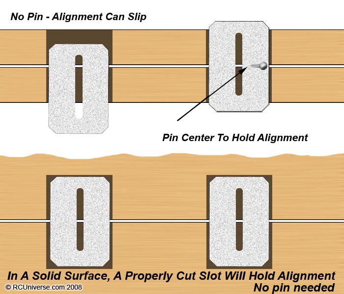

I need a little help here. I have a 4* I'm ready to install the ca hinges.
The hinges are rectangle shaped 1 X 3/4 inch with a slit running 3/4 of the 1 inch length in the center. Which way do I put them in?
They will go in both ways when I pulled the Aileron off per instructions they were in about 1/2 on each side.

answer in arf forum. Slit at right angle.

Push one of the shortest edges into the aileron, put a pin through the hinge so it can't be pushed further in, then repeat till the aileron's got all it's hinges in place, then push them into the wing. Then use thin CA (not medium or thick) to glue them in place, removing the pins when the CA's set. The glue will absorb into the hinge and run up into the wing/aileron. The slit in the centre is to give the glue a channel to run up to give better penetration.

The slots line up perpendicular to the seam (See pic)

Thanks pictures are worth a 1000 word.

I forgot to mention that the reason for that cut-out in the hinge is to allow the CA to wick into the slot. With this type of hinge, drilling the "Wicking hole" in the wood is not necessary.

It won't change how the plane flies, but you have less holding power.
