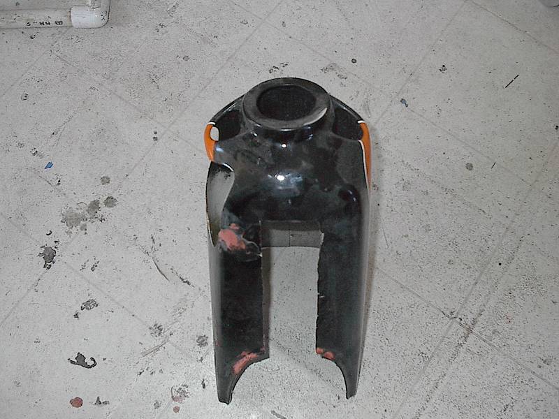

Thanks. I am going to have to close up the front of my cowl, and open up the bottom a little more to get the proper 2 1/2 to 1 ratio. Here is a picture of my cowl. Please let me know your opinion on what I should do from here. I could easily add additional holes to the left and right of the bottom center hole also.

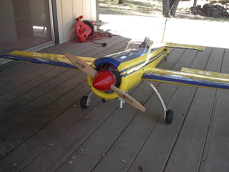

First three shots are of cowls on two Extras, the big one is a gasser and the other one is a glow powered Extra with a YS 1.20 FS for power. They are both opened up with a lot of over kill on the bottom. If most of the engines head is sticking out you don't need as much air flow but both of these planes have had different engines installed at some point so the cowls were opened as needed. The yellow Sukhoi I scratch built and for the most part only the head and muffler are sticking out. As set up I was going to fly the plane and see if it needed more air flow and open the cowl as needed. As it was it never over heated due to air flow over the head so the cowl worked out fine. I have another shot of a scratch built Krier Kraft Bipe with a lot of air flow going in like on the Suk but the head was sticking out enough that it never over heated. Looks like you have plenty of out flow but you opened up the front way too much.

Old 01-24-2009 | 06:51 PM
bonebreak's Avatar
Joined: Dec 2008
Posts: 373
From: Moore, OK
Default RE: Glow plug issue.
I decided to go ahead and re-fiberglass the front of the cowl, and start over. I need some advise on what I should do for the inlet now I will have a blank slate.
Old 01-24-2009 | 08:06 PM
My Feedback: (-1)
Joined: Apr 2003
Posts: 14,400
Received 9 Likes on 8 Posts
From: Hemderson, NV
Look up at the photos!
