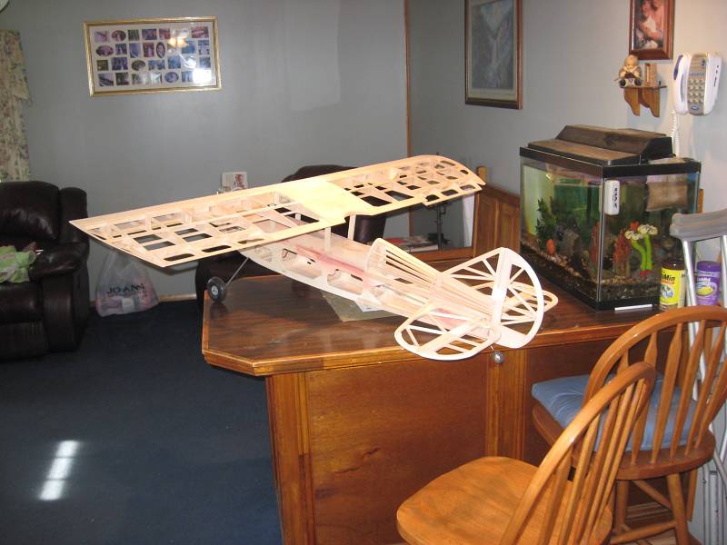

hello , is there any way to set the incidence on a pete and poke without buying one of those meters, book says it should read 1 degree positive. thanks lee i would hate to buy one and only use it once. this is my first build

I am sure there are ways of doing it with math and levels and things as such, however the only way of making sure that it is correct is to use a meter. Maybe you could get with your local club and see if you can borrow one. I would loan you mine if you were in the area. As a side note, most all of the Great Planes kits are designed to have all the incidence built in that the plane might need so if you built it as per plans you should be close. Good Luck, Dave

It's basic math, but that is only necessary if you are designing from scratch and have a force arrangement in mind.
You do still have the plans for the airplane? It's so easy. Just draw a couple of lines on the plans and measure the distance. Generally plans are drawn with the zero line aligned with the edge of the plans, like a boarder drawn around the plans. If it's there fine, if not, then you may want to draw a line with the horizontal stab if that is zero. Then measure the distance from the leading edge of the wing and also the trailing edge.
Now block up the model until the tail is the same distance from a table, front to back. Then just measure the wing distance, and the difference should be the same as on the plans.

Don't over-think this. The Pete-n-Poke is a flat bottomed airfoil. Press a yardstick up under the wing and see where the other end lays in relation to the horizontal stab. Zero incedence would be parallel. Whatever the distance between wing and stab is would be the radius. One degree change would be (2 * radius)/360, so adjust the wing so it ends up by that measurement lower (with the model upright.

I believe the yard stick method would result in an incorrect calculation. Because the incidence is calculated using the center of the leading edge and the center of the trailing edge and not the bottom edge of the airfoil.
When I built my "Pete 'n Poke" I checked the incidence with a meter and it was 1 degree positive. I also, removed the wing and with the stab level (0 degrees), placed a level on the top of both wing struts (front to back) and the struts were also level. The 1 degree incidence with the wing attached was a result of the center of the leading edge was 1 degree positive with respect to the bottom of the wing.
Therefore if my crude calculations are valid the "Poke's" incidence could be measured with a simple bubble level. This method is limited to the "Poke" and assumes my build was accurate as designed.
I would appreciate any comments on this unorthodox calculation.

Is this the only airplane that you will ever own? If it is, then borrow one. If you plan to stay with the hobby, then by all means buy or make one. You can get close with a carpenters level as well.

From what I see in your photo you did a very good job of building too, very nice looking frame up!!
