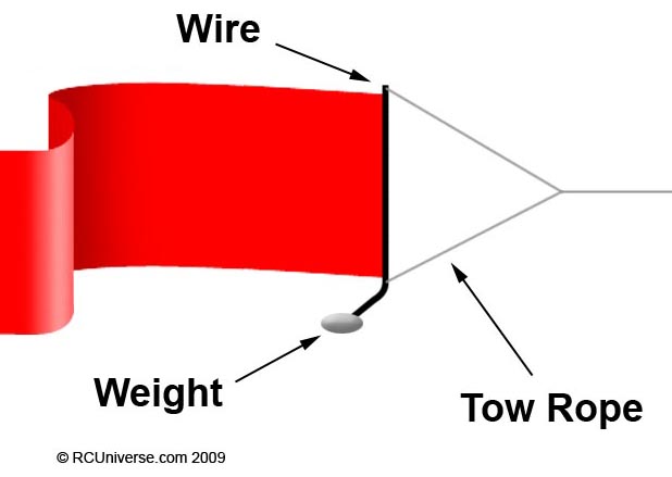

How would you set up the banner to keep it nice and vertical so that it could be read correctly? Our combat streamers, thin and flimsy, twist the string all up.

the fun part is doing it like real life banner towers. They come around and hook the banner with their tail hook like. To keep the banner straight I would put a small weight on the bottom of the front of the batter, this way the banner is not flat.

Here's a basic setup

Yet another great illustration from the guys at getting airborne. I kinda thought that might be the way to do it.

MinnFlyer -!!!!! awesome!!!!!!!! thank's a lot
