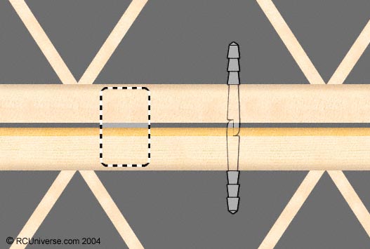

No it is a kit. The instructions called for Robart hinge points (see picture below) for the ailerons and the sig hinges for the flaps. As I hadn't had any experience with sig hinges, I was going to use hinge points.
What is a better method?
Tim

The only problem with using Robart hinges where they are not called for is that there may not be enough wood for them to grab on to.
In the illustration below, you can see how a standard hinge has plenty of hold while the Robart doesn't

Old 02-17-2009 | 10:50 AM
Posts: 3,282
From: Bloomington, MN
Default RE: Hinges
Yup. I had wanted to use some Hinge Points this weekend, but there just wasn't enough structure to make them secure.
I could have taken the covering off of the ARF and added some balsa blocks, but that's not worth the effort to me.

Another critical thing about "hinge points" is that the hinge pin must be mounted parallel with the hinge line.
Also the mount area must be recessed to some extend to make room for the actual hinge pin in order to minimize the hinge gap

The Trim Sabre has plenty of structure on the TE, but is balsa. So given that, should I use CA hinges, or continue using Robart. This is a very large kit, and the TE has a large block of balsa for the hinges to go into. Also, if I go the Robart hinge point route, do I need to use the hardwood block method to notch the control surfaces (these do not have plenty of structure, just foam with balsa skins and fibreglass covering).
Tim
Old 02-17-2009 | 12:18 PM
MinnFlyer's Avatar
Posts: 28,519
Received 9 Likes on 9 Posts
From: Willmar, MN
Default RE: Hinges
If it has a foam wing you can use the robarts and no hardwood block is needed
