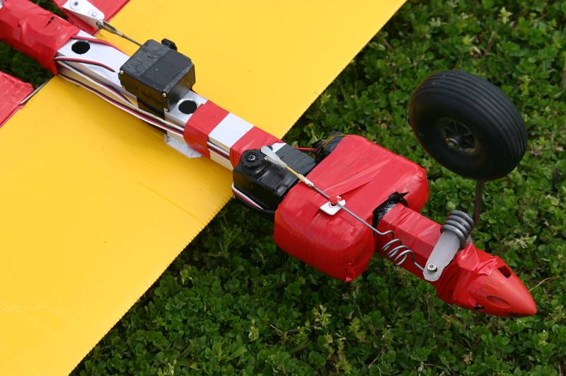

Here is my toughest nose gear linkage. It is on my SPAD Swept-Wing Canard. I love landings and probably do 10 of them every flight. The front of the Canard sometimes slams down very hard. The arm at the front gear also kept breaking on me so I made an arm from a Kitchen cutting board. My arm is jammed into the spring coil of the front gear. Has never broken. The control rod is made of 1/16 diameter music wire and has a coils spring built into it. I always also use a nylon clevis as double insurance for the servo. The rod length almost never requires adjustment.

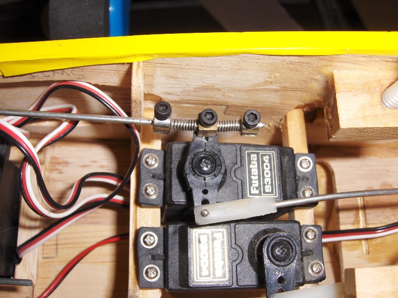

Sorry I can't get a drawing to upload (wrong format) so I'll explain. I Slap one of them DooHickies into the servo arm that you put a wire thru and has a lock nut on. Leave the lock nut off and let the wire slide. On each side of said servo arm/doo hickie put a spring and back it up with a collarlocked down on the wire. the springs strength is based on usage heavier (ink pen) for landing gear. Lighter for using as a throttle side to prevent servo stall when using a non comp radio and get tired of jacking around with the fine tuning

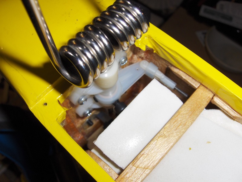

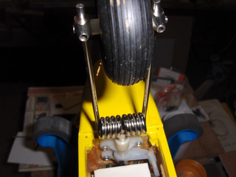

The only nose-wheel I have currently is on my Contender 60 and it's a beefy one. The original set-up didn't have the "oomph" for our rough grass field, heavy 4-stroke engine I added and my heavy building techniques. I swapped out a Fults double strut, added a DuBro "Servo Saver" and it has proved to be rugged - as has the Contender airframe.

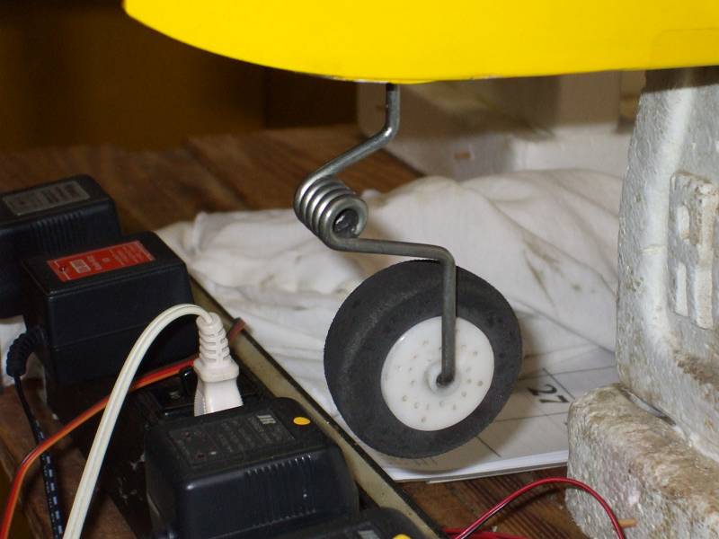

This works for me ! Tower has them for $5.59. Part # LXFV50
